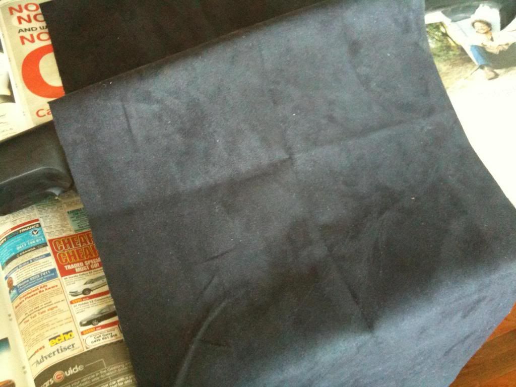

    • suede ( from spotlight)

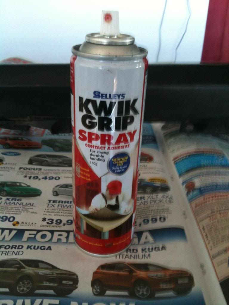

    • spray glue ( brought mine from super cheap)

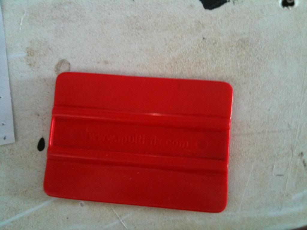

    • plastic applicator

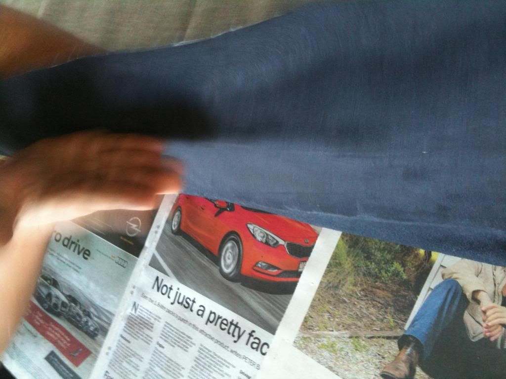

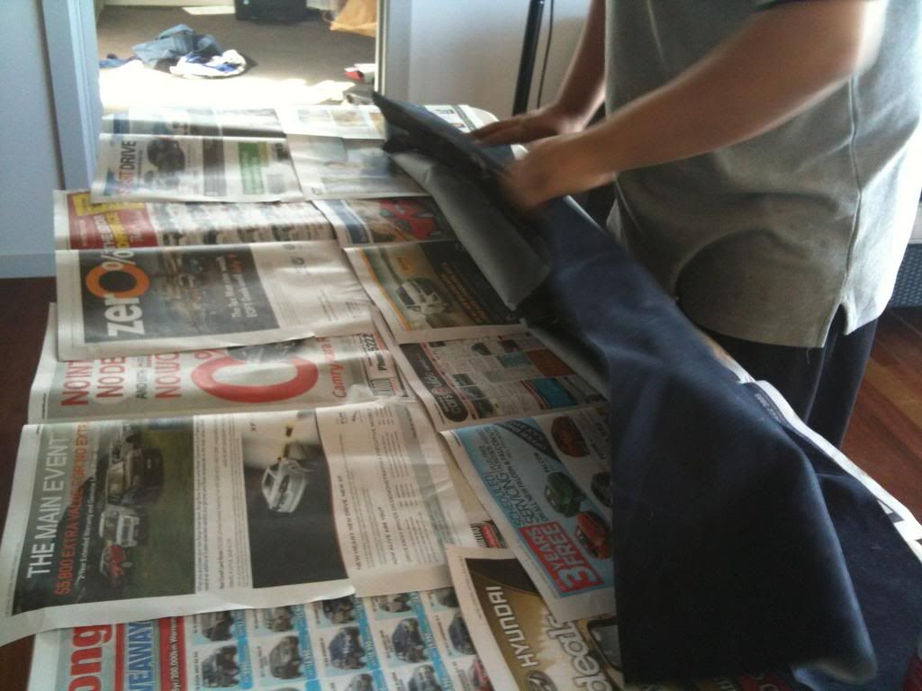

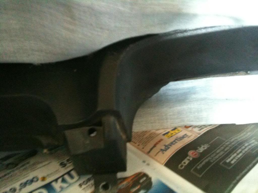

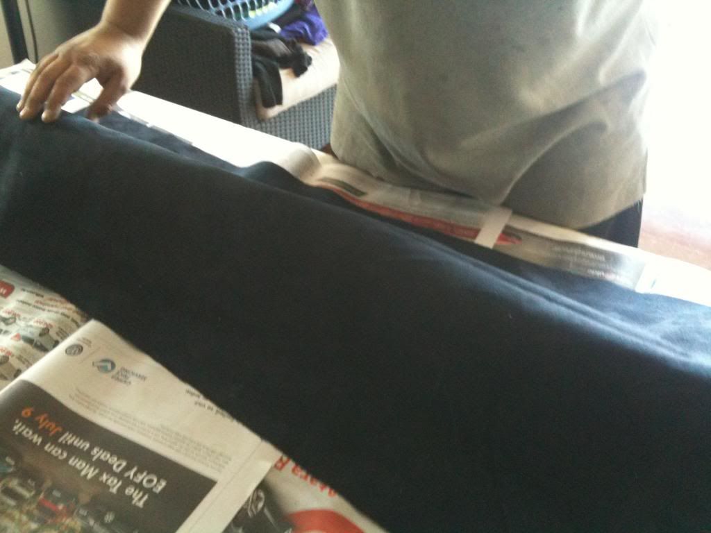

    Work out where to place the dash on your suede and fold it around.
    Work out the edges.

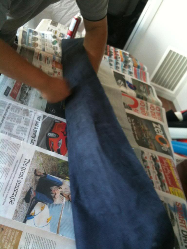

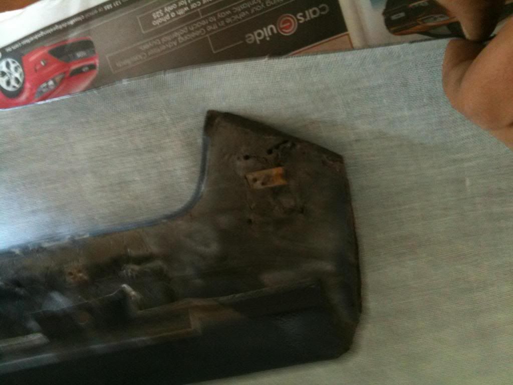

    Then spray glue onto the dash and the suede , let it get tacky then stick them together and smooth out , trying to avoid creases.

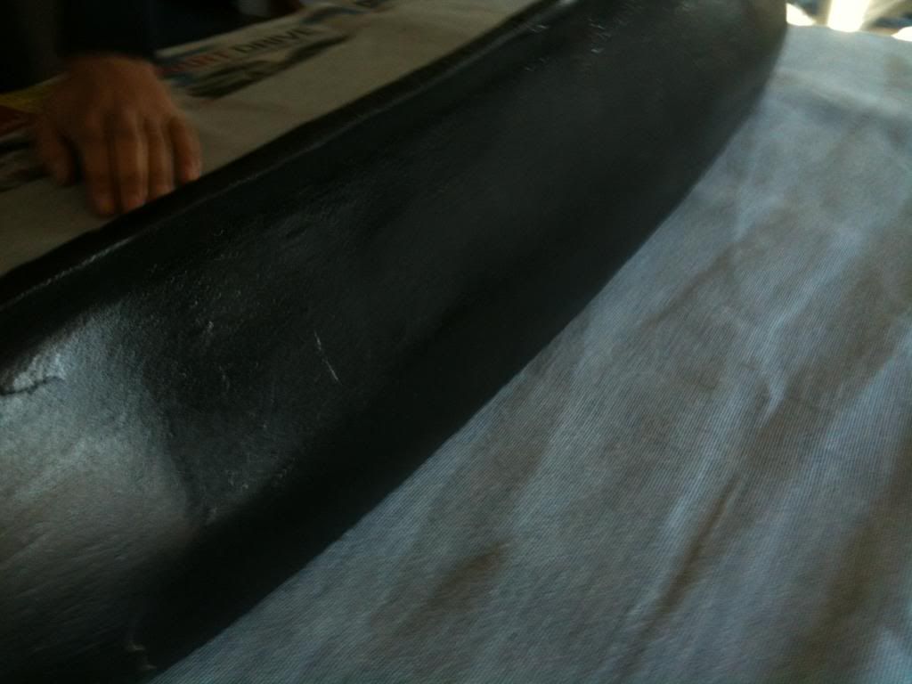

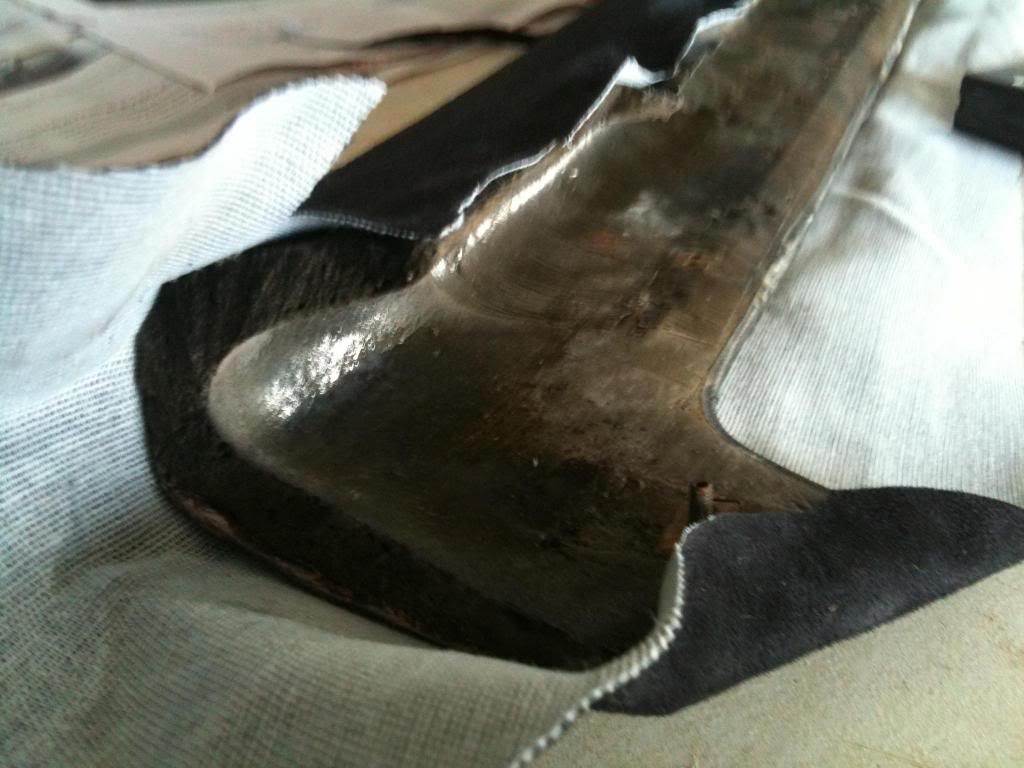

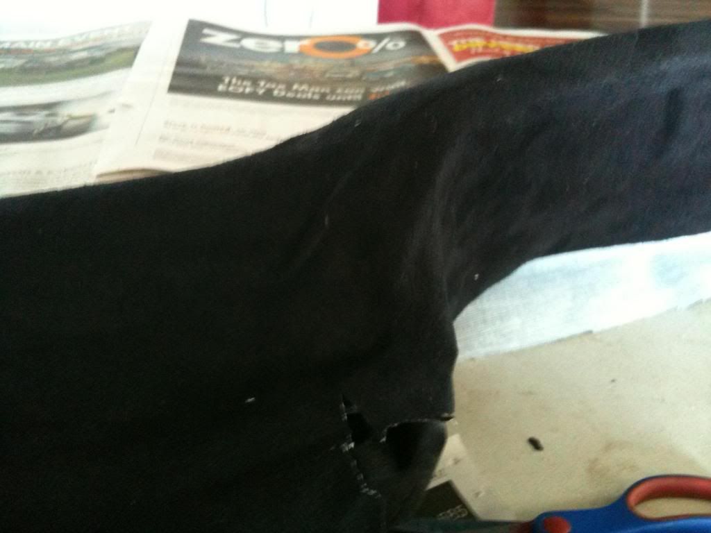

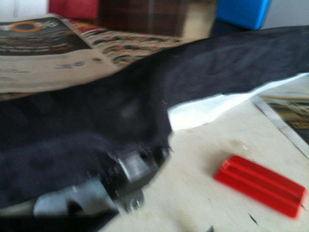

    Slowly work your way around the dash avoiding creases .
    Now the hard part !!
    Bending the suede around the curve !! takes alot of effort and patience .
    Perfect !

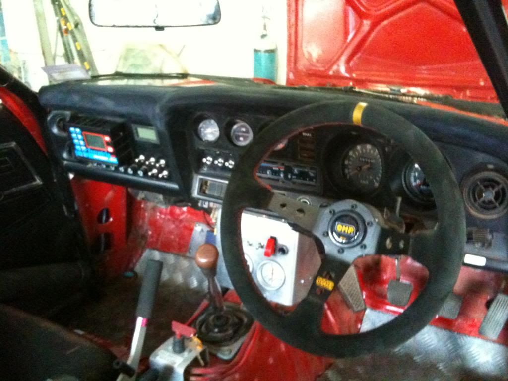

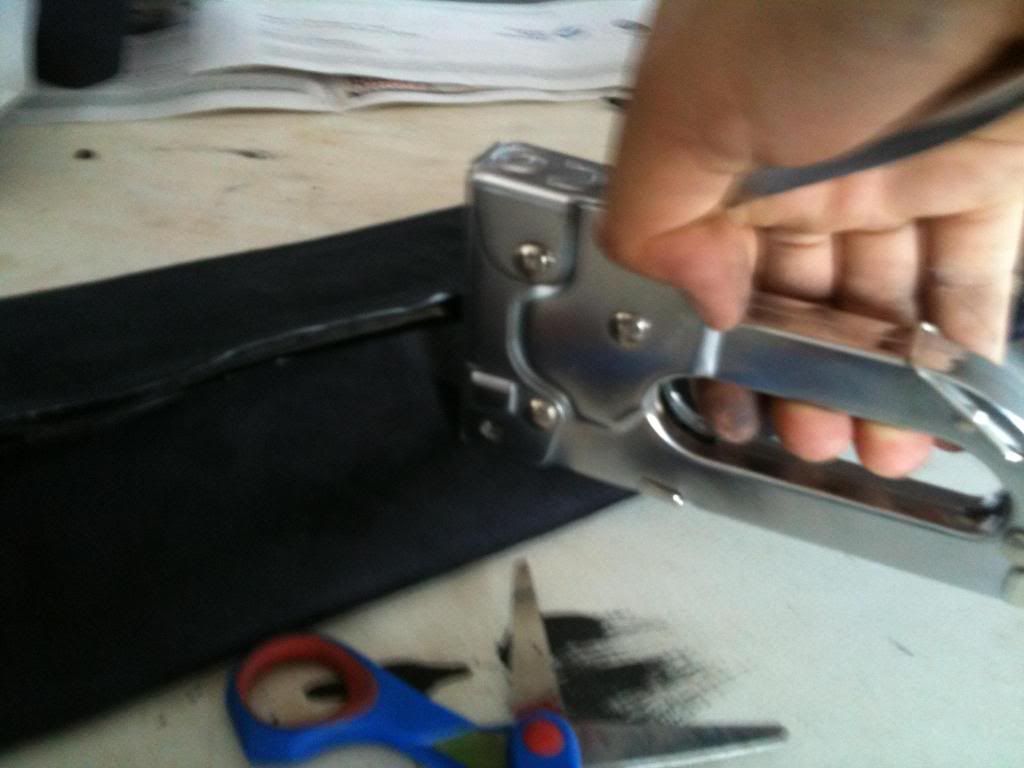

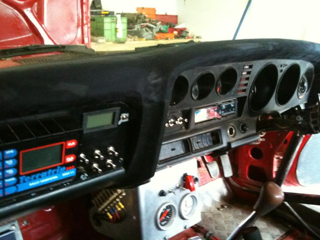

    Now my dash has been cut around the roll cage so the with the end i just folded it around and stapled it .
    Now you have a nice suede dash that looks good and works well !
    Well worth the effort and looks rally spec

    i reckon the biggest challenge is actually filling the cracks first before you cover. i think this is done with that space foam filler.

    Filling in cracks is the easy part ... You can use filler foam , body filler or as I used fiberglass . Worked out fine
