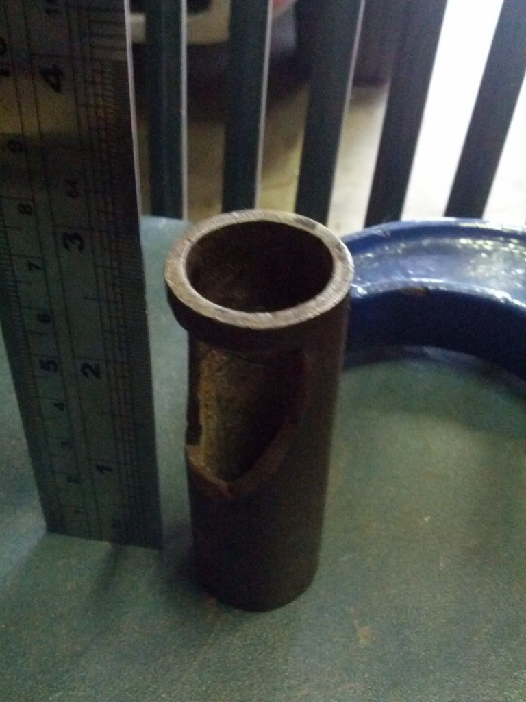

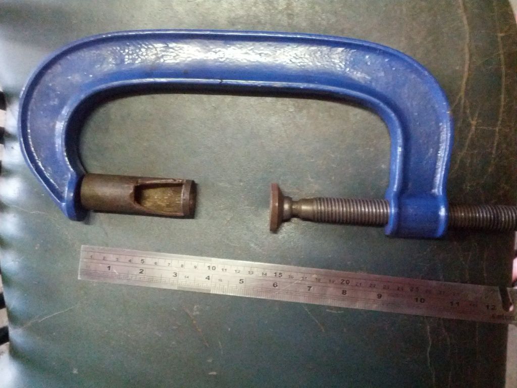

    And just incase Noof - I made a valve remover from a large G-clamp & 70-100mm length of water pipe with a V cut to reach the colettes with a screwdriver

    jb can you post up a photo of your valve puller?
    Would like to copy!

    Does the trick! Threaded end of G-clamp goes onto valve face & the tube onto the valve spring retainer.
    Maybe don't make the tube too long so the clamp can't open enough. 70-80mm is best.

    Very nice JB. I think I will make a 'JB Valve Clamp' too.
