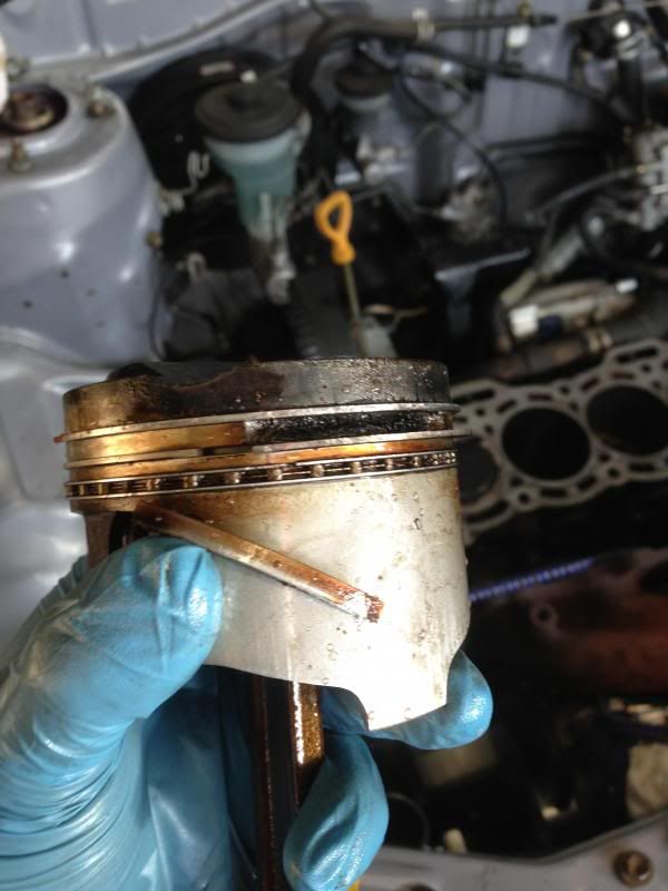

    That will do it every time.. Cracked ring land was the problem. the motor originally did have a blown headgasket on cylinder 3 though. i fixed the the first time with a new gasket.

    good to see you found the issue.
    looks the same as what happened to me and what i was exspecting to see.
    good luck with the rebuild.
