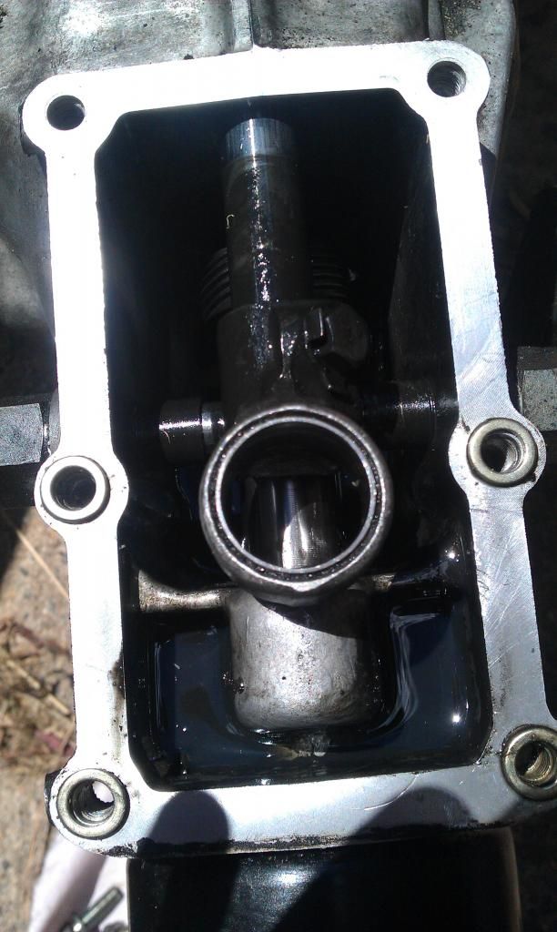

    PS. Heres a pic of what my fucked bush looks like. That ring is the bit thats a right prick to get out. There should be a ring of plastic/rubber inside that, then another ring of steel.
    The brass bush replaces the 3-layer factory design.

    Nah, definately leaking around the front of the bellhousing. Rage.
    Mine does look like that, but it does fill down into the rear housing. I don't think it's leaking at the sandwich plate seals but will confirm.
    My bush also doesn't look *that* fucked, I am pretty sure it still has 3 rings. I did put 2.4 litres in, but it spewed a bit out, so the volume is a bit of a guess at the moment...

    OK, so my bushing still looks fine, but I have solved the issue!
    The rubber gasket that goes between the shift housing and the extension housing... it covered part of the rear selector shaft end cap, and so when shifting into those gears, it provided enough resistance to spring the gears back out.
    I cut that part out of the gasket.
    So it works fine now! Although does need a front seal - leaking quite badly - so the box has to come.out anyway...
