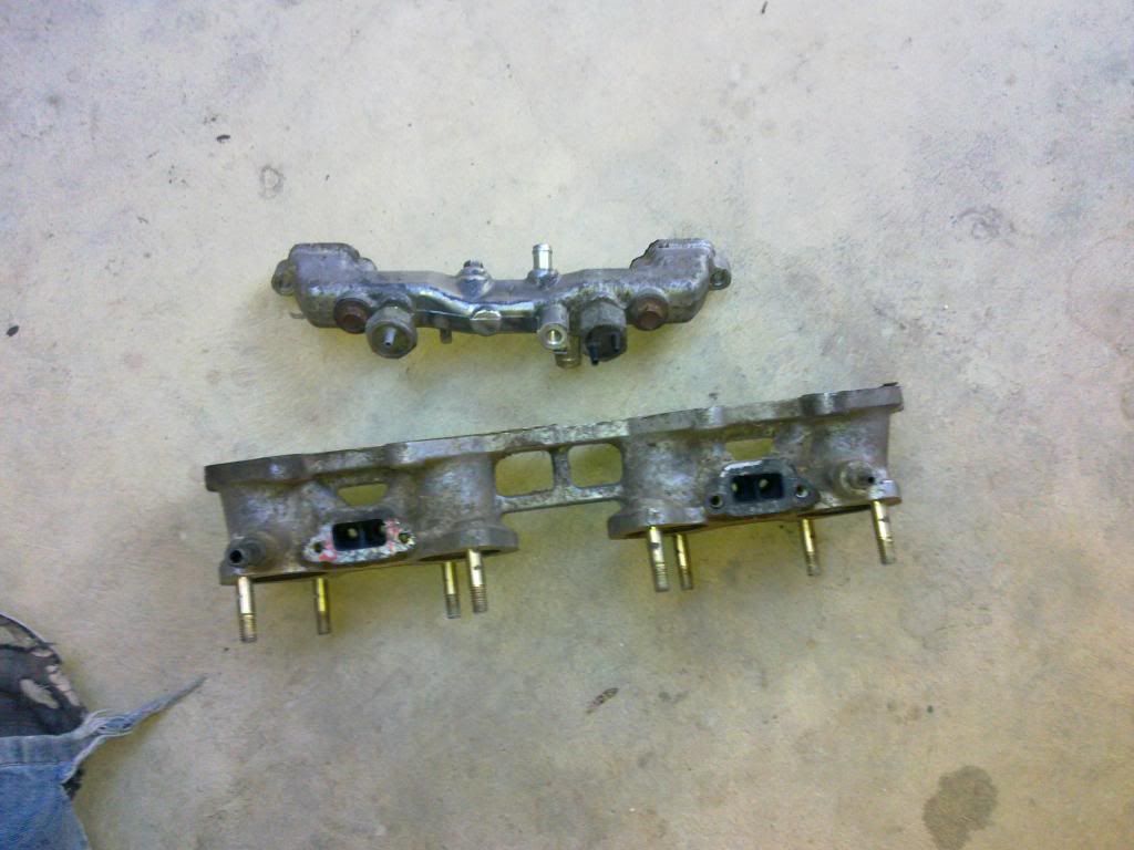

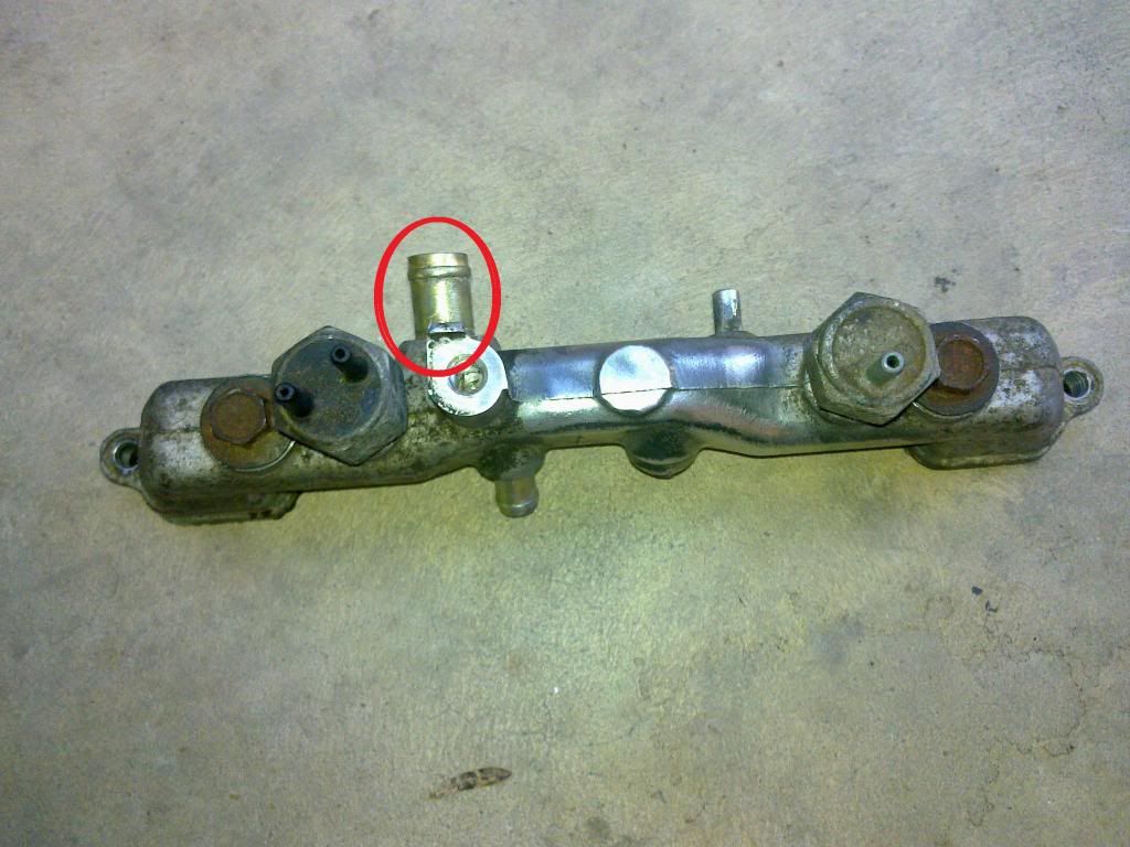

brake booster goes to no 4 which is the far left barbed fitting on the manifold .the 1 iwith the red circle is for the solinoid valve that goes to the rocker cover
on the tube the bottom 1 goes to the pvc valve
also no 1 on the inlet is for pollution
