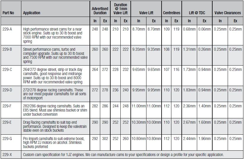

    Default Re: Has anyone tried Camtech's 1JZ cams yet? Cam/spring choice thoughts?
    Quote Originally Posted by ATMO_BT1 View Post
    Good point, I actually think you might be able to use 2J cams in a 1J if you use the matching springs & retainers? Have you heard that? I had a look and Kelfords 2J 264s actually have 9.65mm but more interestingly run a 272 on the hot side, I don't have any experience with staggered cam sizes so I'm not sure how far north the 272 exhaust cam would push the powerband.
    fitting 2j cams in a 1j requires some machine work...
    good news now though is Kelford do cams for the 1jz so if you are interested i can get a set for you
    Here is a listing of cams for the 1jz for you to browse
    Recently a WA workshop fit a set of the 2jz 264/272 cams to a supra with t04z...
    it was making 430 @ 18psi prior to cams
    after cams made 490 @ 18psi
    final tune made 519 @ 20psi
    I dont actually have dyno graphs of it all etc just word of mouth but it was good enough for the mechanic who installed them to want to order his own set...
