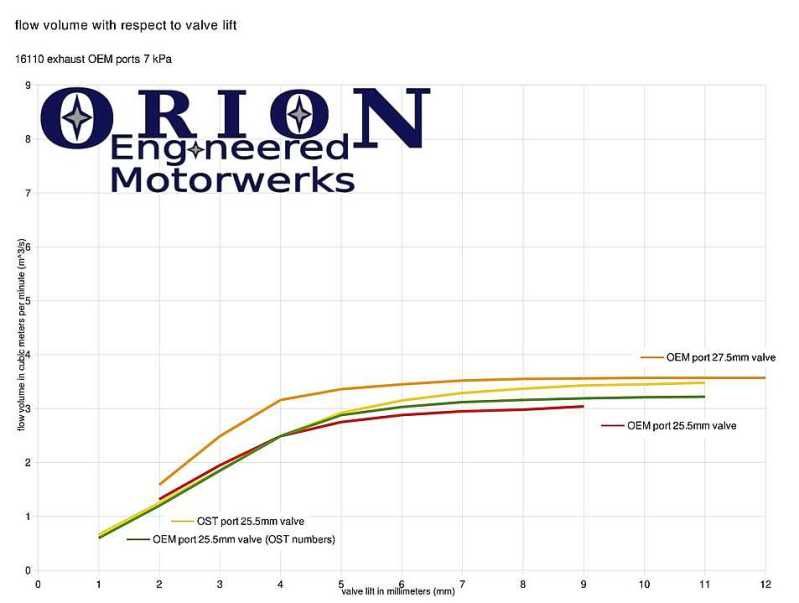

    232 cams close the intake valve sooner so they provide a bit more time for the piston to compress the air/fuel charge... allowing for a bit more bottom end - low end torque... flatter torque curve
    The lift doesn't account for a whole lot of boost because the port(stock) tends to crap out somewhere between 6mm and 7mm of lift.
    green and red lines are stock valves on stock ports
