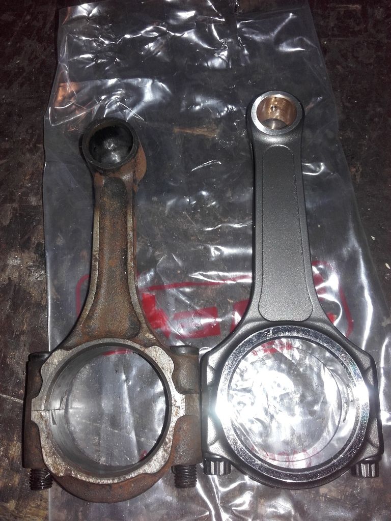

    Quote Originally Posted by ToyTA22 View Post
    It can be confusing to people who have never dealt with rod length/ stroke ratios. Basically the angle between the rod and bore is less with a longer rod which means piston is achieving more of a straight up and down motion rather than being pushed sideways, which a more acute angle creates. The basis is less sideways push less friction and less loss of energy at the mid stroke point, means a freer revving engine and very minor increase in torque. Hope this helps.

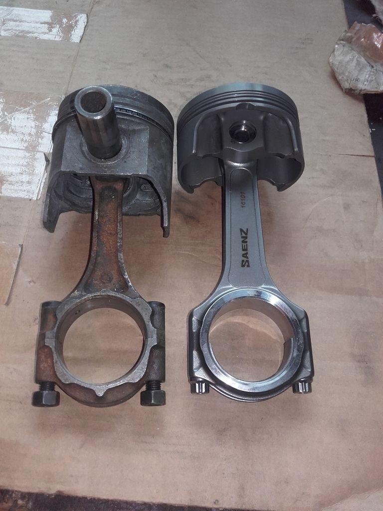

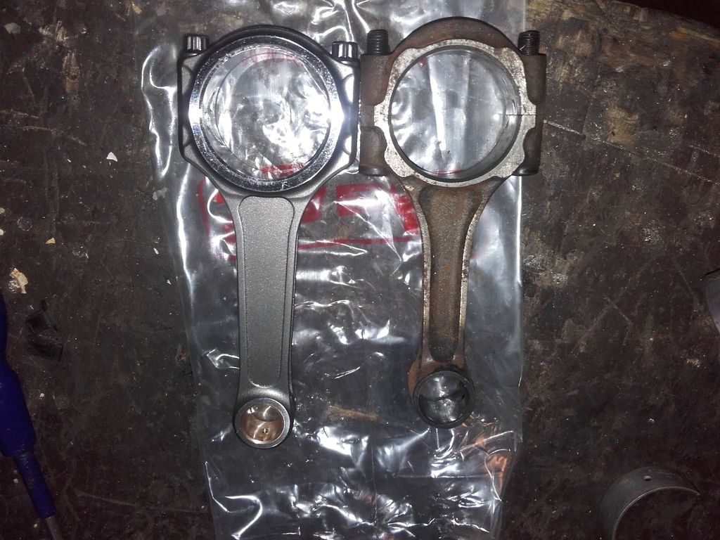

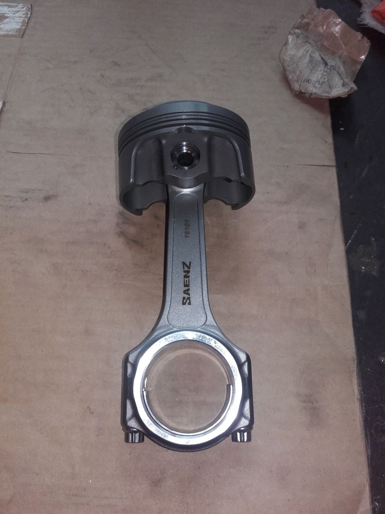

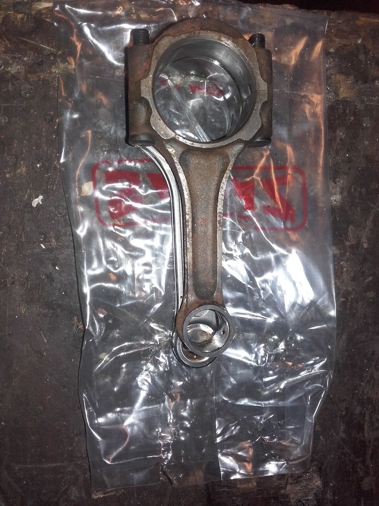

    toyota 2tg long rod /short piston, 14mm longer than standard
  7. #52
    Jul 2007
    10,259
    Default Re: 2-TG N/A Cam Options - Real world results wanted
    those must have cost a pretty penny!
  8. #53
    822

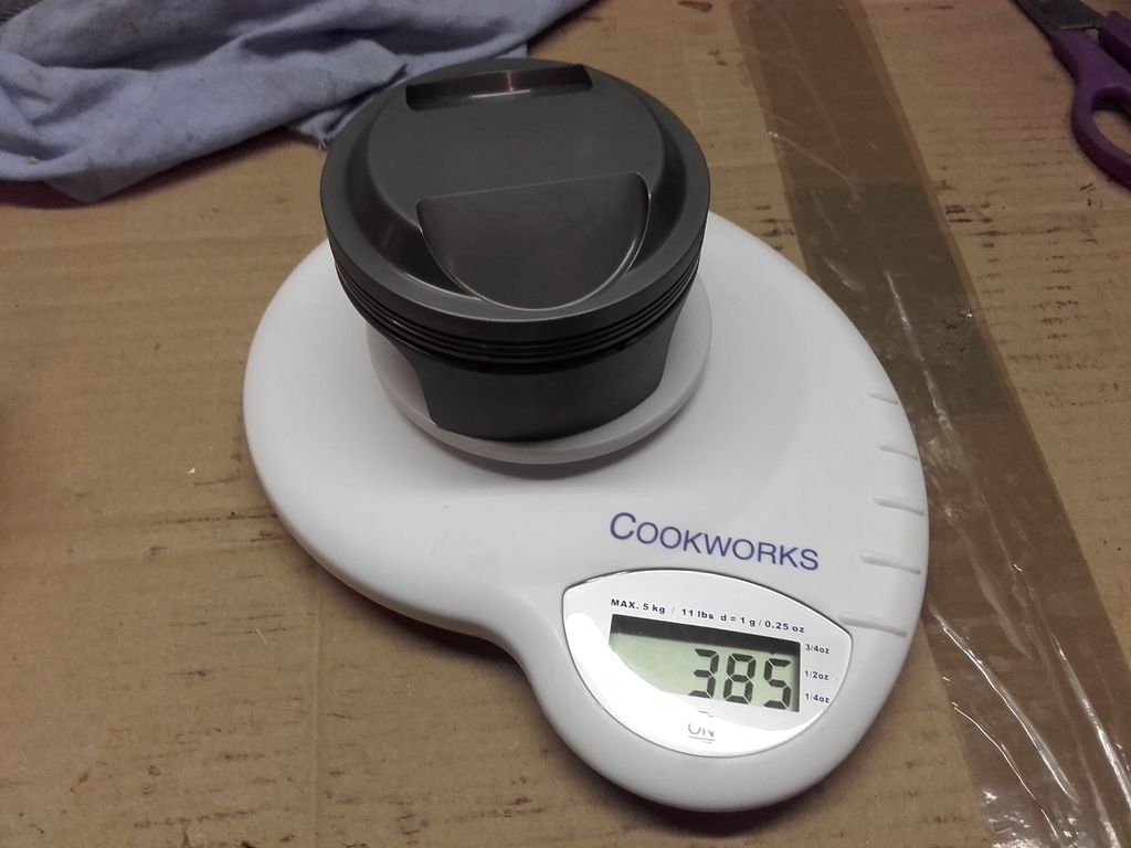

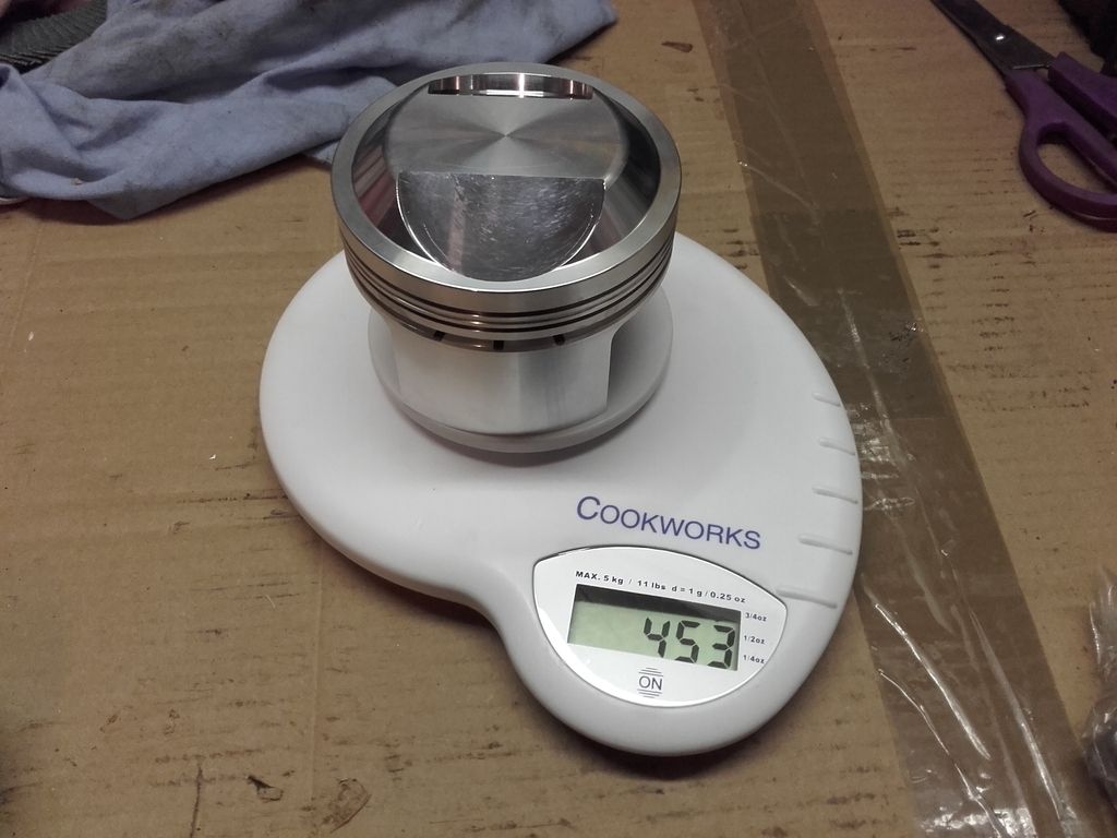

    nice, is this for the 3tg you were building with the 84mm crank? what are the specs on the pistons? Rods are same as 2tg just 14mm longer?
  9. #54
    Apr 2014
    co down
    13
    Quote Originally Posted by stidnam View Post
    designed pistons to my own specs
