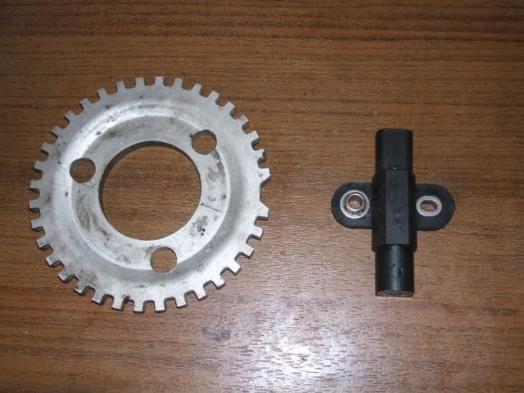

What's the ID of the relieved area in the front of the crank pulley? AU Balancers have a 36-1 trigger on them that presses on, they are easily removed and if the ID is in the vicinity you can machine the pulley to a press fit and press it on. Then use a bracket to mount the sensor. Works well.
ID of relieved area: 114mm

For the $10 to buy a 36-1 trigger wheel in a variety of sizes why would you bother pulling the balancer off a dirty coon and rooting around with it? Just modify a bought one to be a press fit if u dont like the idea of bolting it...
Never late in an x8
The ford trigger wheel is of the EDIS variety - proven tooth design, light, msextra has no problems with the tooth pattern, I have an EDIS VR sensor. I can see what JZK25's getting at as it would be a simple mod to fit a wheel over the outer face.
The EDIS wheels are a popular item for folks converting motors to EFI and/or waste-spark.
But ... I think the EA unit looks like this:
whereas I would need something that looks a little more like this:
But as noted earlier, http://www.trigger-wheels.com/store/.../en-uk/d5.html have a wheel that fits (the 5.75" wheel with 4.5" hole item).
edit: rather than machine the face to make a trigger wheel press-fit, I'd do something like drill & tap M5 holes on the inner edge of the trigger wheel, e.g. hole centre where it touches the raised edge of the balancer - then loctite in some cap-head bolts. They'd hold the ring on plus the prevent rotation of the trigger wheel.

Press fitting is better than bolting to the inner puller area. I have seen the carnage that can cause.
we did both on my ring gear.
Press fit + bolts for bonus security.
...... butt scratcher?!
any thoughts on just notching out the 36 -1 teeth on a standard (sintered?) balancer and mounting the sensor to suit?

AU trigger is no good, too small for your balancer.
