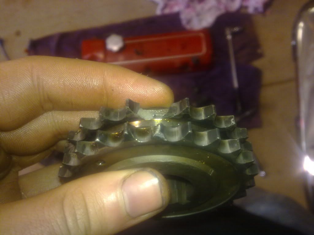

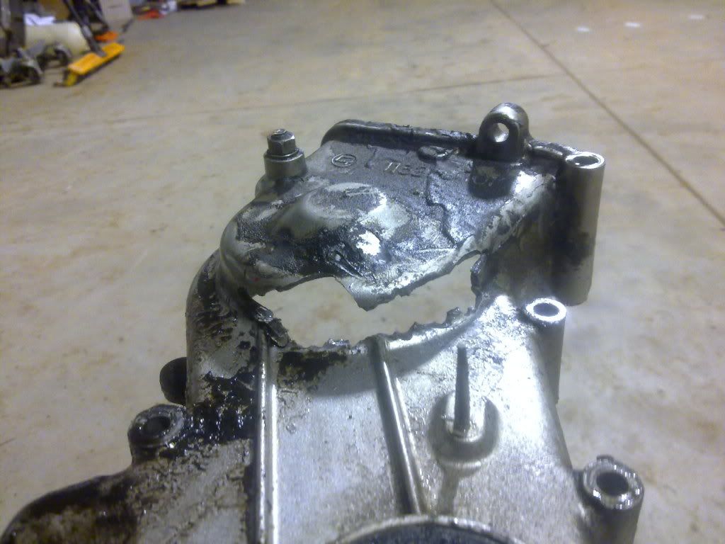

    Doesn't matter now anyways, cars dead, have to rebuild AGAIN! Tooth broke off and jammed up the chain:
    "The chain is jammed in this position =P Looks funky hehe.
    The chewed up timing cover, Lucky I have spares.
    Missing tooth.

    Geez that must have made a helluva lot of noise and chaos when that went like that........gotta love simple motors like the 18R to fix easily enough!

    Actually, it made bugger all noise XD just a little pop and then the sound of driving over stones and flicking them up under the car from the pieces of timing cover... I pulled over right away to avoid as much damage as possible.
    Should only take a day or two to fix once I have all the parts ordered in. It sucks though, I don't have a car to pick the parts up, or the money at the moment. I'll manage =)

    Gee, wasn't that long ago that you were talking about modifying an engine that ran a timing belt because you thought chains were better.

    Hey, I now retract that statement ;P Atleast if a belt does go, it won't rip apart the timing cover!
    Hmmm.... I'll look into a BEAMS eventually now. This has changed my perspective on certain engines.

    The tooth is more likely a result rather then the cause.

    Yeah I know, Hence why I'm pissed off! It wasn't an old chain! Only 11,000kms on it when it went.

    Default Re: Weber 32/36, Low Idle no matter what I do.
    I learnt the same way you have. If you change to new chain use new sprockets/gears as well, the gears wear more than chain does.
    The chain can jam in worn sprockets/gears
    Nah I have 3 spare timing covers =P Thanks for the offer though. I'm taking the sump off today to clean out all the bits of chain and timing cover, Also removing the Aux cam and bearings as there is half of key way stuck in it. Again I have a spare Aux cam =D
    Where do I get new sprockets from though? I thought you couldn't buy them new?
