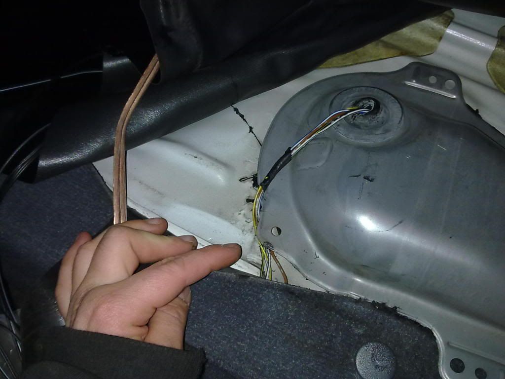

    Haha, ummm, I think I found the problem boys...
    http://i1054.photobucket.com/albums/...7062012191.jpg
    The fuel tank cover was very dodgyly placed down with nothing but that sticky stuff that sticks the plastic onto the inside of door panels behind the trim, and doesn't even look like the right one for my car LOL. Alas, the wiring was also very dodgyly placed and snagging on the sharp edge. A good dose of electrical tape around the individual wires and the whole length of that particular loom took care of that. And then there was this...

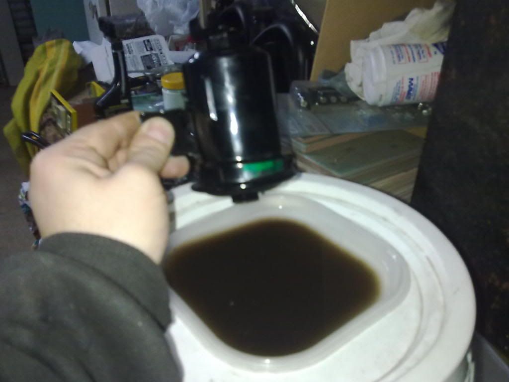

    http://i1054.photobucket.com/albums/...7062012192.jpg
    Yep, that dish is only a few millimetres deep. And that was only the start. Seeing that my dodgy Ebay replacement filter from the UK wasn't made properly (lesson learned) I couldn't get it to stop leaking on the inlet side, so I had to reverse flush the old filter out as best I could with carby cleaner just to get back on the road. Don't suppose anyone knows where I could get a cheap filter from that will actually fit properly? Otherwise I'll just focus on getting the 20V back on the road and selling this one, which I should be doing anyway LOL...

    FWIW, I just bought a Genuine Toyota filter for my 20v Levin today for $71.20 + GST, trade price.
    Good to see you found the problem, and it was a simple one in the end.

    Let that be a lesson to everyone, always start with the basics before you go doing any further exploration. The reason I didn't was that I figured "the filter looks pretty shiny under that little bit of dirt, it probably was replaced not long ago". REPLACE IT ANYWAY!!!
    A few days on and still no issues to report, will keep you all posted either way though...
