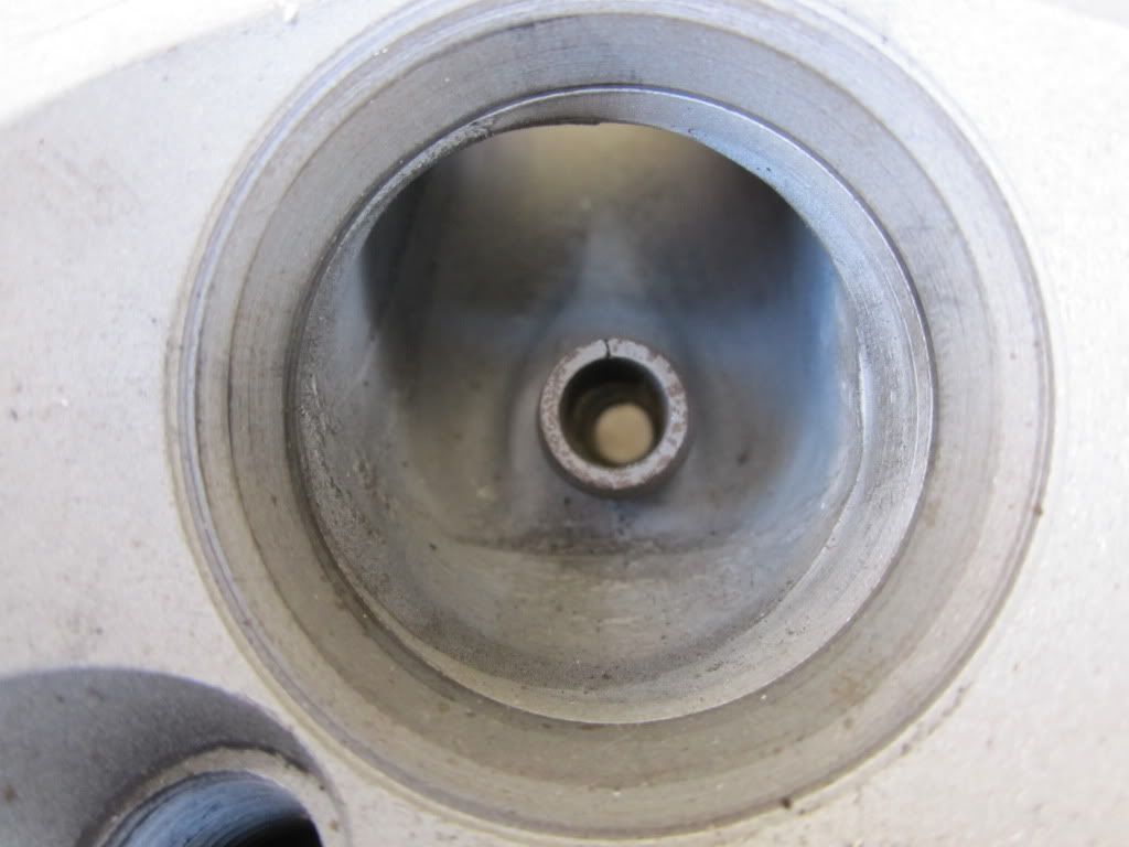

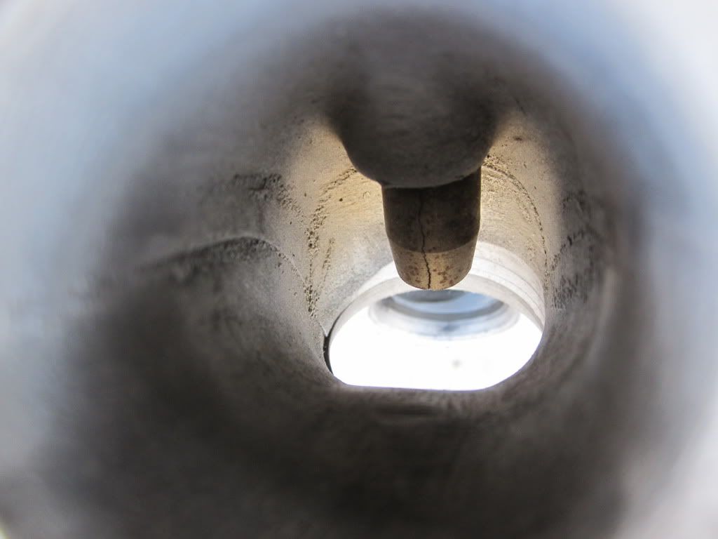

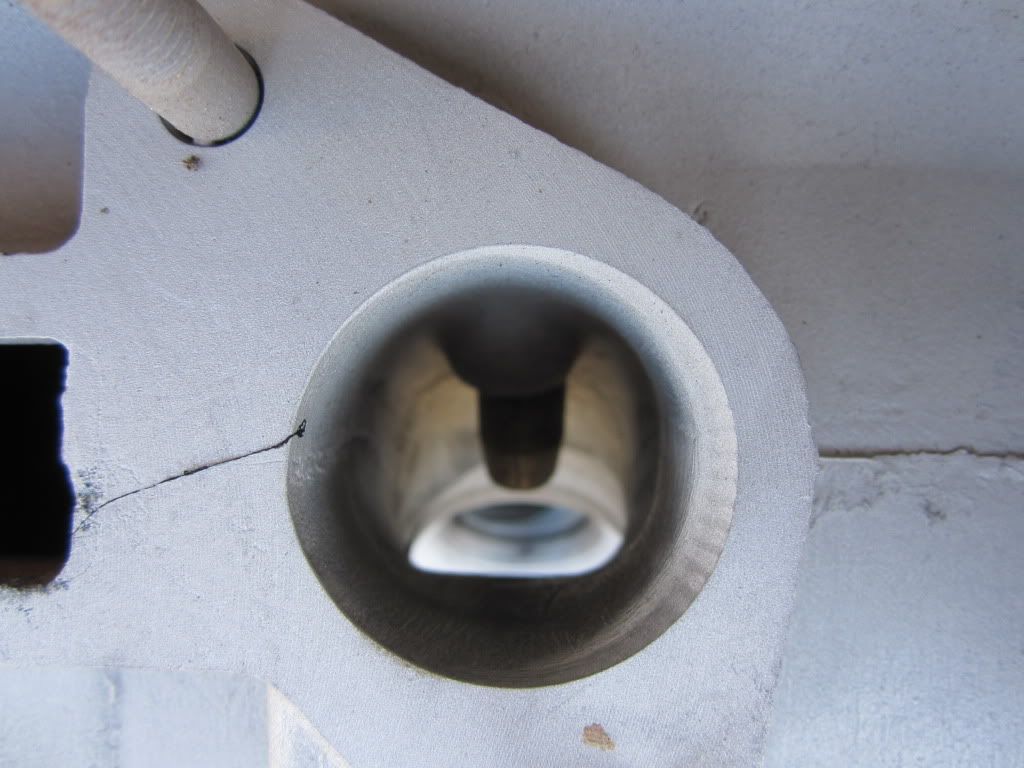

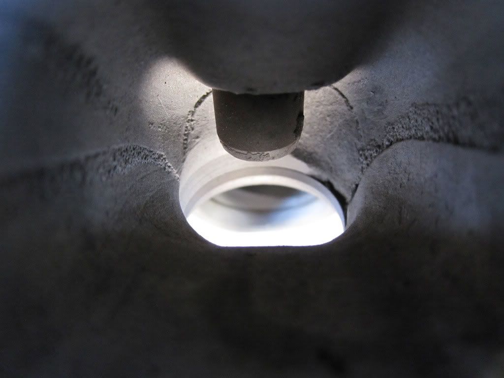

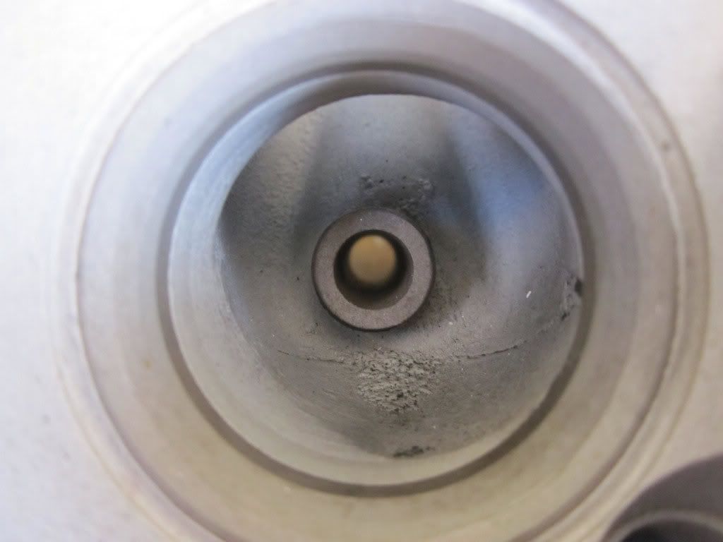

    VAASA / FINLAND
    225
    Default Re: 2tg head flows
    There is also good and "Bad" heads from early 220 and 222 numbers..
    just take some photos at most bad 2TG ports what i have seen.. this is one of my 2TG heads what is laying around garage.. ports are far away at correct places..
    SO there is differences between heads a lot..
    that looks ugly, I've not looked closely at my 222 head but hope to soon to make some backyard port job. looking at those pics is it possibe to recover those ports?

    VAASA / FINLAND
    225
    Can make head what is usable, but make it "good" maybe only head with all out, but still need some welding behind valve seat. There is ~2mm step behind valve seat at other side of the ports. That may need a fill with small welding operation.
    Thats why the head is empty and used for only parts..
