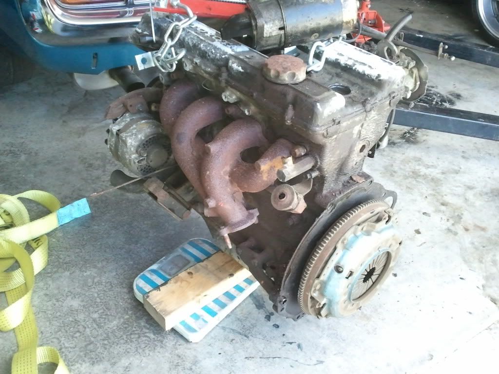

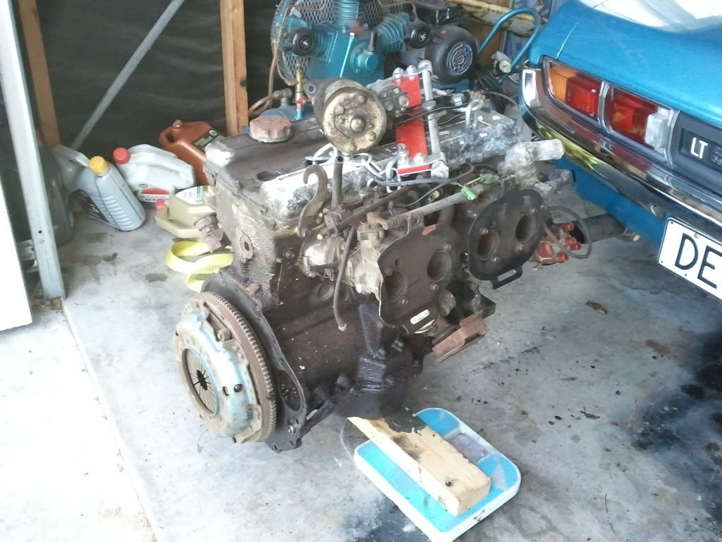

    an 18RG when weighed on the same scales that i used to weigh my 1UZ, 1JZ and 3TGTE weighs 175Kg's.
    which is ALLOT, i knew these motors were heavy but i didn't think they were this bad!
    anywho, this is how i weighed it and this is what was included in the weight.

    jeebus christ, that is a little weighty.
    That said though - the carbies and manifold are about 2-3kg heavier than EFI version, the cast iron exhaust manifold is probably around 10kg heavier than a set of extractors......
    ..... and the block is a massive cast iron lump of tractor motor.

    Love the balancing act!!!
    That engine lifter is what caused it to be excessive. Did you have the fan belt on there too?
    Otherwise, nothing wrong with how you measured it using two bathroom scales, good work cause now we all know how heavy these suckers are.

    after i posted that i wondered if id fucked it up because 170 is allot!
    so i did some googeling and it turns out 170 is on the money, there is even a thread on the old forum confirming the weight.
    my 1UZ weighs 205Kg's with aircon pump, power steering pump, alt, manifolds and starter. the 18RG is a serious lump of iron!!
