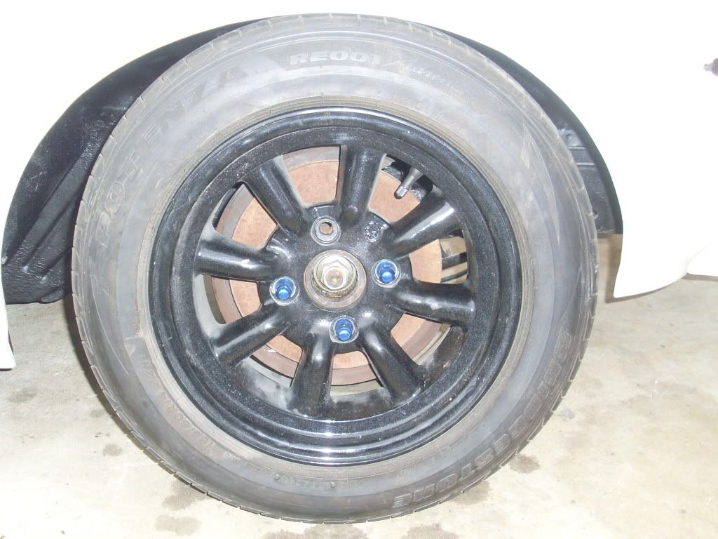

    i used an ra60/65 crossmember and rack with a ke70 collom. i have also used s13 coilovers and cut down and strenthened cressy lca's im running 14 inch wheels so i the biggest brakes i could use were ca18 silvia brakes. the geometry seams to look ok. but i have -4 degree camber.... which isnt such an issue as this car is for track..
    i havent driven the car yet so im yet to see what its like. if the s13 sus is poo im going to run ra65 struts and brakes.
    here is a pic of my set up. p.s i did all this before anyone was playing around with the ke70 stuff. looking back now i would have gona ke70 front end....
    and a camber shot.
    big brakes..... inside 14's lol
