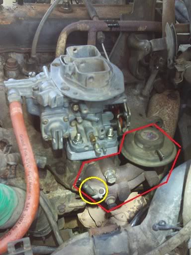

    Im after some advice regarding the Toyota 2Y engine as fitted to hiluxs
    The problem seems to be that exhaust is finding its way into the intake manifold to such a large extent that it is actually blowing the air/fuel mix out of the carby.
    I replaced the stock carby with a Weber 32/36 DFAV that I just rebuilt.
    Far less complicated and no birds nest of EGR & Vac hoses to diagnose.
    Problem remains the same with new carb.

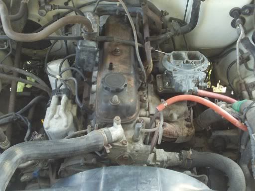

    Obviously the accelerator cable, fuel hose etc is only there temporarily.
    There appears to be some type of EGR valve (circled in red)
    When bolted to the motor exhaust gas comes out of the nipple in yellow with significant pressure and as mentioned above engine barely runs whilst blowing air fuel out carb.
    Decent amount of pressure at tail pipe with some amount of unburnt fuel in the gas.

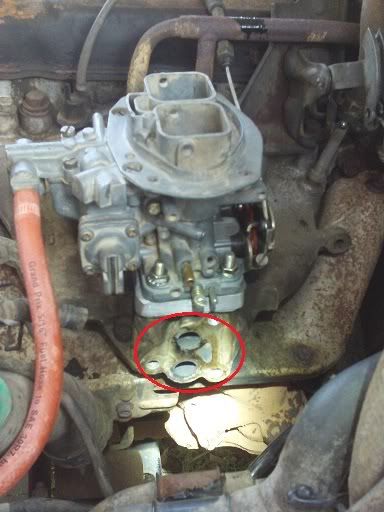

    When the valve is removed The engine runs far better through full rev range, to the point of being drivable but again with a massive amount of exhaust coming from one of the holes where the valve was, and barely any exhaust comes out the tail pipe.
    I did make up a block off plate and it has the same symptoms as when valve normally in place.
    Any ideas?
    Thanks

    I'd put teh plate back on and disconnect the exhaust before the first muffler. My bet is the muffler is blocked. It will be really gutless if the exhaust is blocked. Also, make sure you haven't bellied out and squashed the exhaust pipe.

    i just made a plate to block that off when i put the weber on, but id say you have a blocked cat if it has one if not muffler has collapsed

    Thanks fellas problem sorted. Got a chance to pull it apart yesterday, blocked cat.
    Replaced and good as gold
