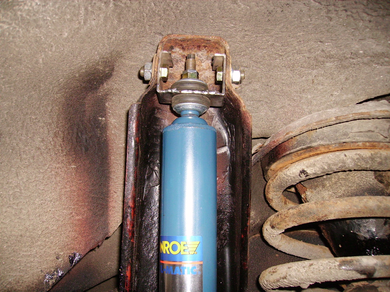

    Strange.I have rear shocks from MA61 on my MS123.The upper side is not the same.
    http://www.polkatulk.se/Crown84/supradamper.JPG
    In front i'm using shocks for Volvo 140.
