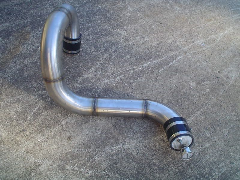

i found this out by accident, i had a leaking oil drain pipe i made and i welded where i thought it was leaking. I sprayed the inside with degreaser and sealed both ends with my hands and shook it, as i did this pressure built up and degreaser started spraying out a tiny pinhole where the last place i would of looked. The pressure wasnt extreme but enough to find a pinhole leak that i was trying to find for a long time
hope this helps
