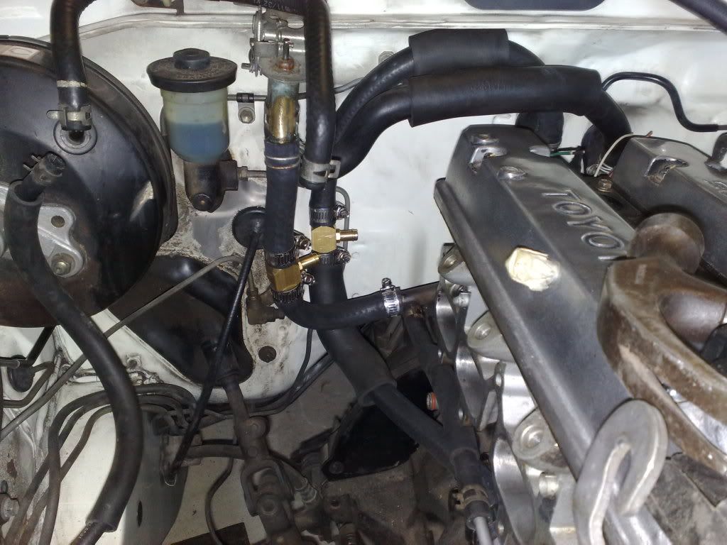

    Cool np thanks guys. Hey I was thinking about tapping into the the two water lines that go to the throttle body on the intake manifold. They seem to be about the right size. Any recommendations on the best place to take water lines from?
    458
    Default Re: 4agte successful turbo mounting configurations - T25 ?
    T's from the heater lines perhaps?
    111
    4,083
    Quote Originally Posted by RT40Corona4AGTE View Post
    is where i tee all mine into.
