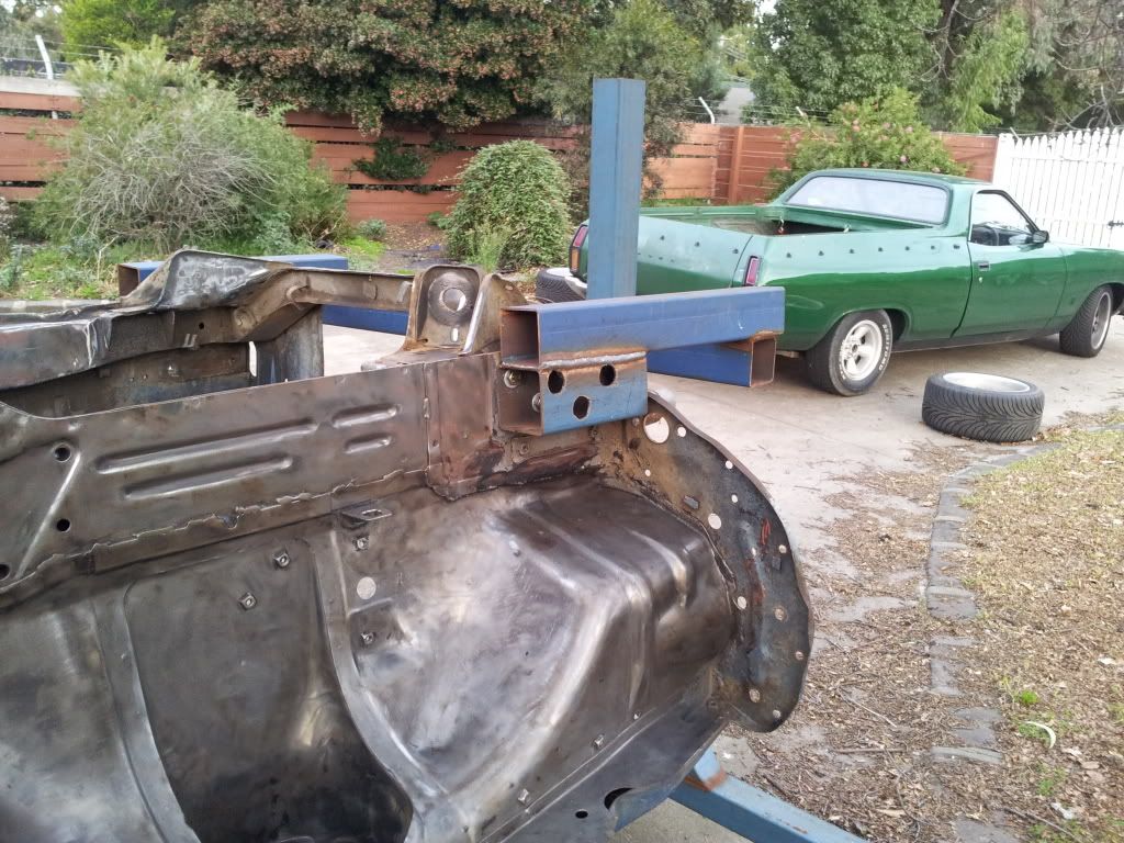

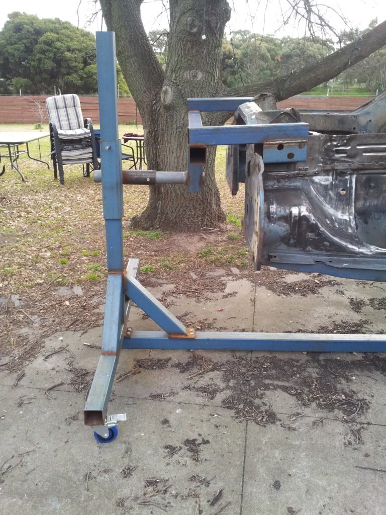

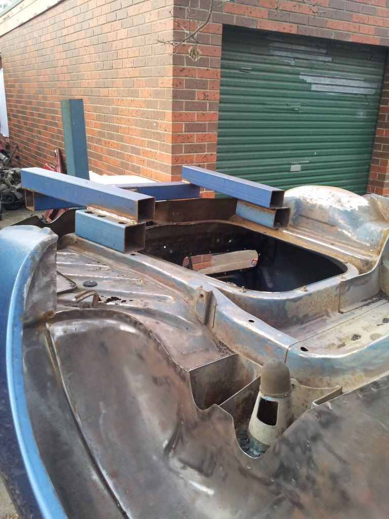

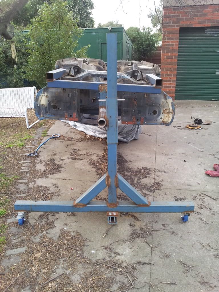

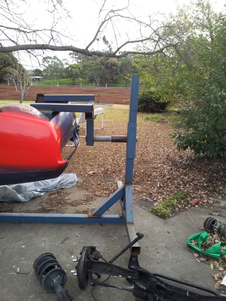

    here are some more pics of my beefy rotti.
    If anyone wants dimensions just ask. I'm pretty sure this one is a bit overkill just for the shell, but should help when i am doing suspension bits and whatnot (cause there will be a bit of dammying up and whatnot)
