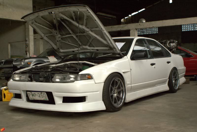

this will be our first conversion to toyota power..

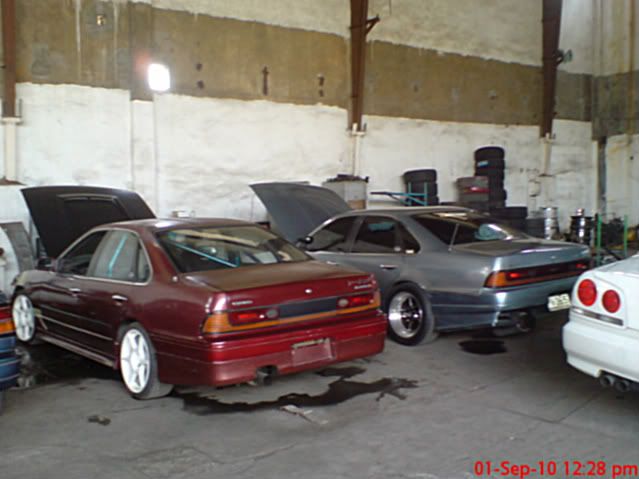

some of the cars in my friends garage..i think thats my engine back there

i got addicted to drifting and wanted to upgrade my engine..so i hastily sold my rb20det came from r32 gts-t and got myself a 1jz gte matic,now my concern is converting it to manual..i've been researching and checking options on the web and saw that w55-58 can be used,cant afford a r154 and from where i come from its hard getting that pulltype trany..so i was able to get a w55 and im on the process of using the bell housing from the matic trany to make fit the w55 thru machine shop'ing' the two..im confused about the spline part..
