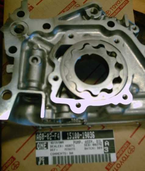

    Here is the oil pump pressure relief...

    is that the oil pump change between the bigport and smallport 4AG or whatever the series were?
    not sure WHEN the change occured, but if you use the 19036 pump you'll be using the newest

    Those pumps above are both big port pumps. Small port pumps have a lot more sharper teeth.

    Quote Originally Posted by Ken_T View Post
    small port pump
    for complete oil pump info - http://www.hachiroku.net/forums/showthread.php?t=15957
    111
    Default Re: 4age oil cooler pressure relief
    I see. I was going off this. Which I see in that thread to be backwards.
