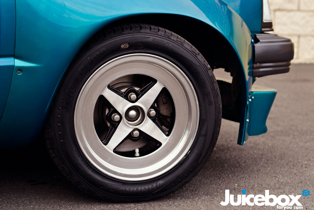

    S13 280mm rotor and FC 4 pot fit in an early 1 piece 14" work equip 01, AJPS uses 260mm EG6 disc so might fit and shouldn't the KE caliper bracket be similar to AE86 so AJPS kit should fit.
    http://juiceboxforyou.com/wp-content...10/11/dkp5.jpg
