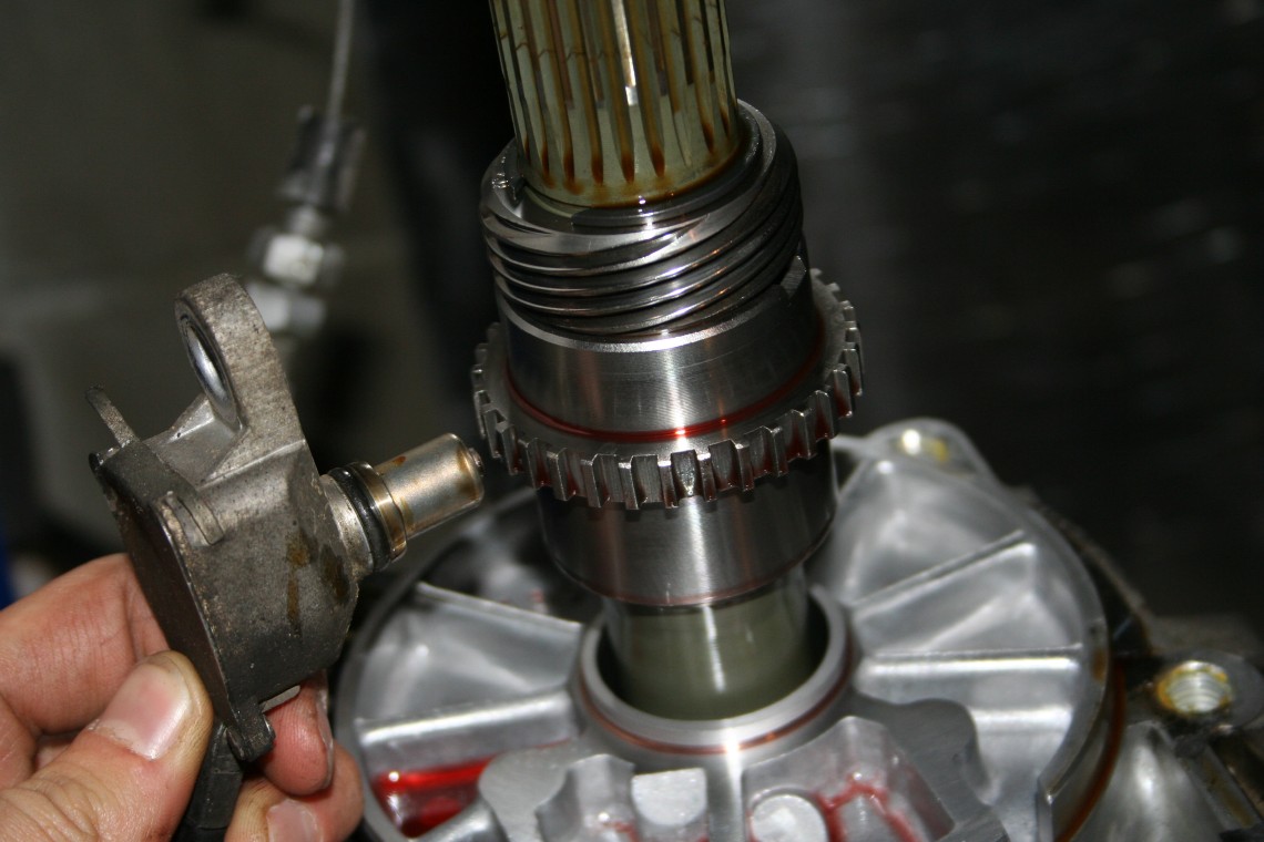

    I thought Sideshow made a converter box to fix this issue? I have a 1JZ cressida GLX with no ABS, and uses speedo cable. I get code 61 too.
    This is what the speed sensor and gear looks like on my spare A341LE JZX81 box.
    The Jaycar kit might be the way to go it seems, has anyone else tried it?

    Engines out of JZX90s, JZS147s, JZZ30s, a bunch of 1UZs, etc use the 2 pin inductive sensor with the 4 blade rotor.
    The Jaycar kit, in theory, can adjust from 1% to 99% either up or down.
    So the 32p signal can be adjusted down to 3.84pulses (88% down) or 4.16pulses (87% down) which should be close enough.
    Given it only goes up to 99% it would only be able to (just under) double the signal, hence can't multiply by 4 (although you could try 2 in series for 3.96).
    Note - I have not tried it, but these are the specs.
    Ribfeast - that's the sensor that spits out a 10V square wave given the correct power supply (usually powered by the ABS ECU).
    There is also a speed sensor available (somewhere - I think Sideshow mentioned it) that goes inline with the speedo cable that can be obtained in various output rates. The speedo drive usually divides output revs by about 5, so if you get a 20ppr sensor for the speedo drive it will output close to the required 4ppr of output shaft.
    The sensor has an open collector output which works fine with the pullup on the SP2 input of the ECU (or at least a JZZ30 ECU).
    HTH.
