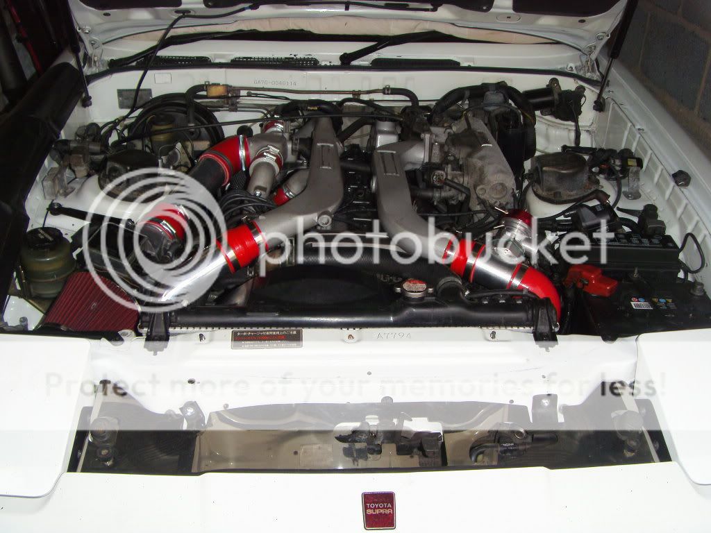

    i'm gonna be rebuilding my CT12's over the winter so i thought i'd have a look at upgrading the actuators too. what psi rating do the standard actuators have? can these be rebuit/upgraded if so to what psi? or is there a direct replacement that will do the job?

    the rebuild is nearly complete just got the 3" exhaust system to finish.
