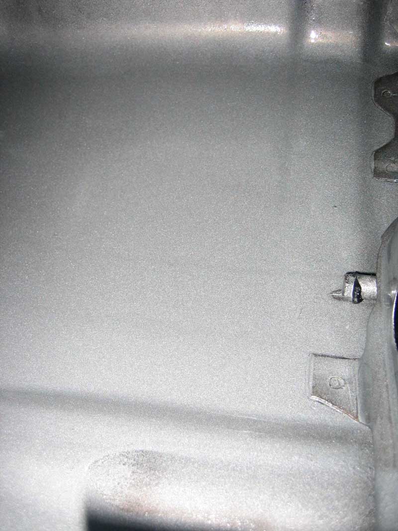

Here is one photo after the first round of shaking:
Obviously it needed more shaking to get the inside of the surge chamber coated.

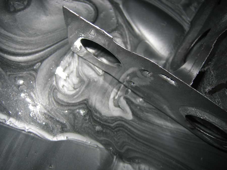

At this point I reached inside with a spraycan cap and poured a bunch of the sealant into the surge chamber.
Reclose tank. Shake tumble etc. Thanks to my buddy who helped me juggle the tank.

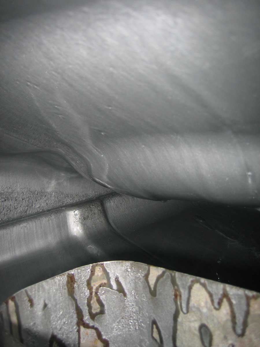

After more shaking:
The coating came in a 1 quart can (approx 1 liter).
This is tons of coating to do this tank.
After all the shaking and tumbling was done, I drained the extra coating out (as per the instructions) and put it back into the can. Approximately 2/3 of the original volume came back out of the tank. The coating is quite a bit less viscous than I thought it would be.
The shaking to distribute the sealant was far easier than I would have guessed.
To help show the thickness (viscosity) of the coating:
