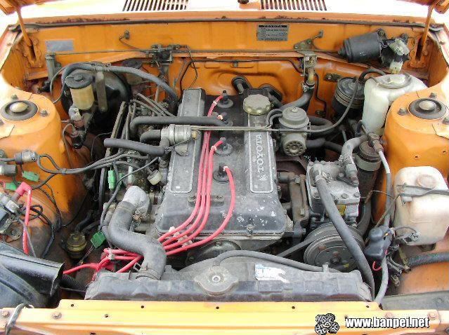

    ta45 gt carina. this is the reason to check sump bulge. not all 2tg's came out of ta22's...ever wonder what the unused bolt holes on the cam cover where for. thats right yuckie pollution gear. cast iron aircon bracket is interesting.

    Looks remarkably like an 18R-G to me.

    100% correct Mr River.
    the 2tg has the breather pipe between cyl 3 and 4 on the cam cover
    top radiator hose outlet on left side
    and no spark lead hold down block on the front area of the cam cover
    and most importantly 2tg's are not tractor motors..lol

    Cool, thanks for pointing out the differences. I was never sure and always get them confused.
    Aye, the 2T-G is not a tractor motor. More suited for a Bobcat or forklift, I think.
