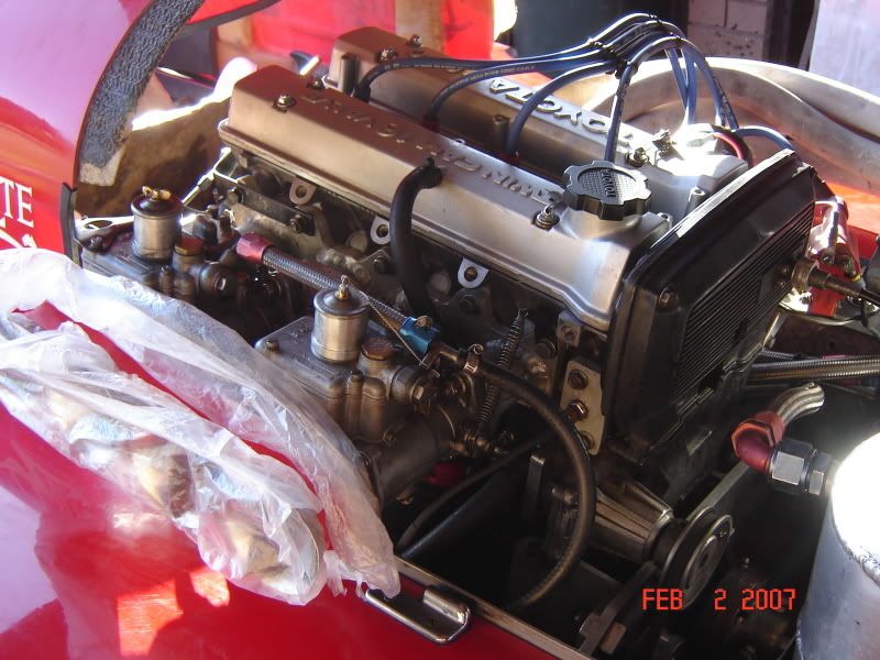

    yep the 1.6L hydro class, uses either ford kent engines or stock 4age's.
    a good mate of mine runs that class. just finished his new boat actually. they are generally capable of 80-90+mph (stock blue or red tops with webers and dry sump) in the right boat.
    as far as i know, his new boat doesnt run anything special. doesnt run a water pump, just pressurised cooling from the rudder iirc. doesnt need any special cooling system mods, just always run the boat for a while with fresh water after a run.
    old boat:
    well have to see what gen is better the ke30 or the ke(yuk)25

    ...any pics of the rest of the boat??

    only this one..

    Looks like a wicked bit of gear.
