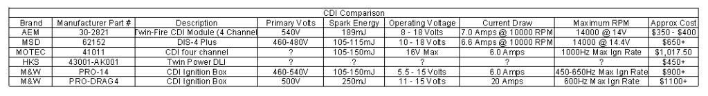

    I try will post up a comparison of cost, spark energy and features for some of the common CDI's sometime today.

    Bang for buck appears to be AEM from the specs of the units I have looked at so far. But I am still weary of their reliability issues, even though they have replied to my email and said that they have resolved the issues they were having.
