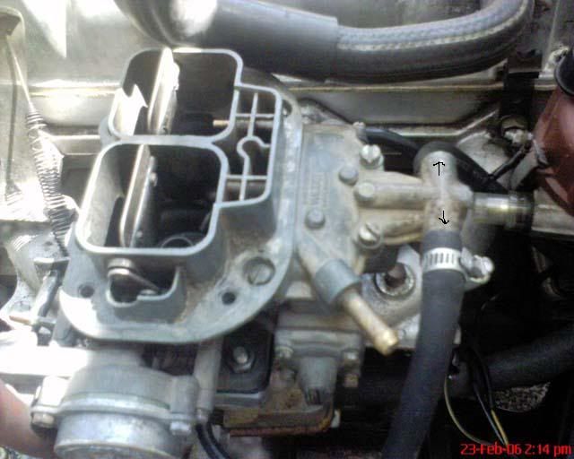

    install the adapter so that the carby is mounted away from the rocker cover as much as possible (the weber is rather large)
    as you are aware the ta22 were fitted with linkages.
    you'll have to modify the part of the linkage that connects to the carby
    does your carby look like the one in the photo (especially the linkage end)
    http://i465.photobucket.com/albums/r...by20photo1.jpg
    Jul 2010
    Australian Capital Territory
    7
    Default Re: ta22 2T weber 32/36
    yeah the linkage issue and where certain hoses are and where they go is what im seeking with photos
