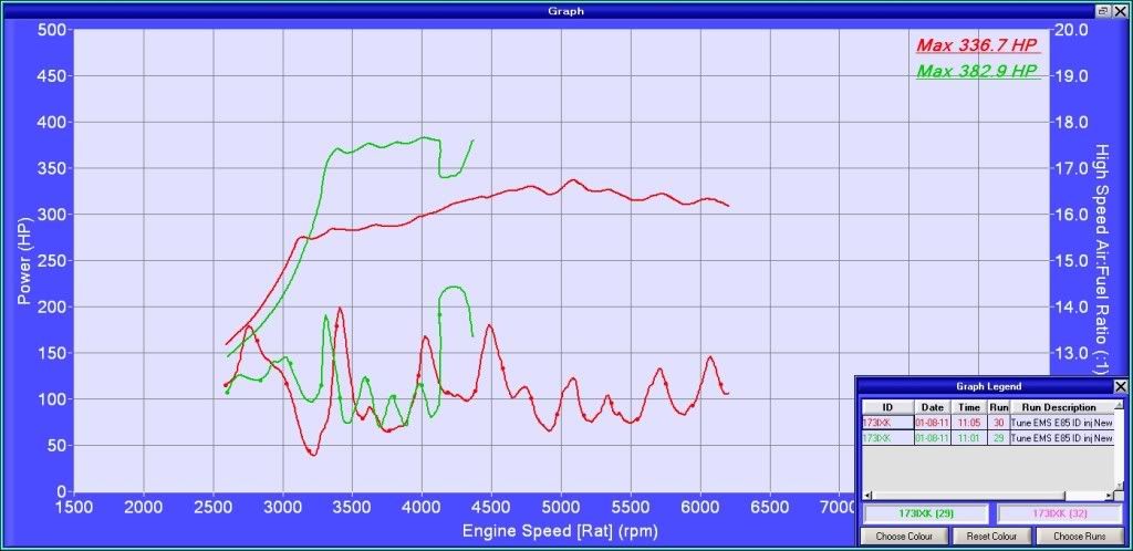

    After doing valve springs, hg's (with arp studs), had it on the dyno today and no ,if very little change at all.
    This time though i got the data logging
    It seems to have a problem going lean around 4500, it then misses but afr's go back to normal after that.
    Doesnt do it on 10 psi
    Still doesnt explain the lack of power though
    I have the data logs but they are .elg files and i dont have the program to open them, if anyone can help with some id then i can email them.

    can you post the fuel & spark maps?
    no audible missing during the ramp up?
    AFRs bouncing around like that (assuming this is picking up the AFRs in the dump pump not way out the back where it could be pickup up atmo oxygen) do suggest a fuel issue (FPR, pump, inj map, inj opening times, etc) and/or spark breakdown of some sort (still). I'll re-read the build thread to see what hardware you have...
    It (the ECU) is not trying to do something silly like close-loop AFR control during acceleration?
    edit: am happy to look at log files, am sitting in from a computer anyway so any work-avoidance is welcome.

    260Hp before the turbo is a pretty decent figure, what had been done at that stage?
    As far as the current tune looks, what was with the 380HP run? Seems like it wanted to pull...Toss some bigger injectors in and run it up to 18psi?
