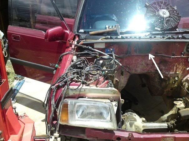

    not mine but this is where i mounted my ignitor..
