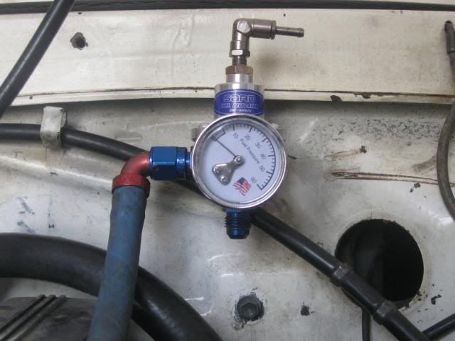

    Picked up a Sard pressure reg with my new engine package, never run one so just wanted to confirm set up
    So was going to bring the the feed from the rail into the side of the reg where the line is fitted now, and going back to the tank from the bottom of the reg. Is this correct???

    correct!

    yep thats it, block the other side of put a gauge on it.

    That's how mine is connected on the GZE, been working for over a year.

    I assume the "gauge" and feed from line ports are interchangeable? The way mine came is with the gauge port on the side rather than the front (with a plug installed)
    I gather by the gauge and blingin fittings that the reg started life at mscn, so all holes are now NPT?
    Nope.
    Gauge opening/hole is a tapered thread, whereas feed opening/hole is not.
    The gauge hole is also BSP thread as shipped from sard, so if we assume that they are tapped to suit, and appropriate fittings are used?

    I'm all good for fittings all dash 6 just wanted to know routes
    That's why i was curious whether those two holes are interchangeable - your gauge is where my feed from the rail is

    ah really I haven't pulled it apart yet, just running as it came from the other car

    I bought my reg brand new of ebay so I doubt it's been tapped, and on mine those holes are not the same.
    What makes you believe they get retapped?

    you can get an adaptor from dash-6 to NPT in alloy bling or low-tech brass. Just take gauge and FPR to a speed shop that sells that stuff.

    I think I got my brass adapter from Autobarn IIRC.
    We seem to be agreeing with each other now, i am confused
    http://www.mscn.com.au/scripts/prodV...?idproduct=390
    Quote Originally Posted by MSCN
    *Sard fuel pressure ports are 1/8"BSP This makes it difficult to screw a aftermarket gauge into. Motorsport Connections can fix this on purchase by re-tapping the thread for you to the common 1/8NPT. Please note this when purchasing.
    You'll notice that he has the fuel pressure gauge MSCN sell as well, so i made the assumption it was bought there, and tapped. I too bought mine on ebay (genuine) and have since had it tapped, but i didn't think to check if it was tapered or not.
