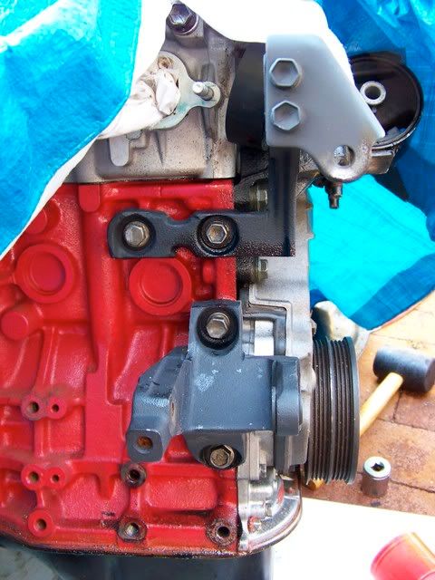

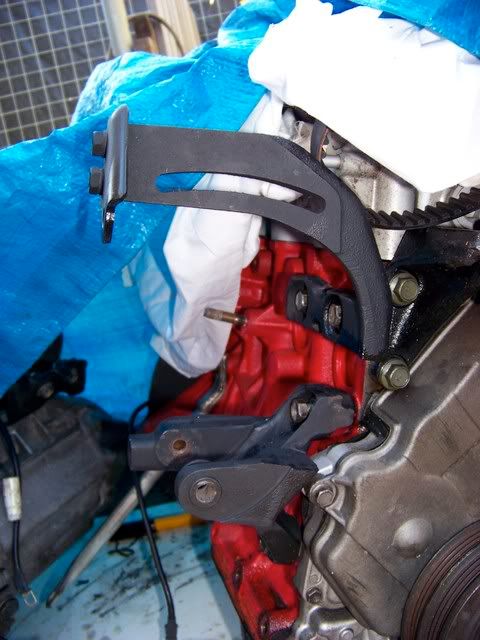

    idiot me. there's a dude on ozcelica that i sold a MR2 bracket to to fit to his gen1 3sgte and he's put up pics. dunno what took me so long to realise this would help you....duh.
    he cut it up tho to save weight tho.....
