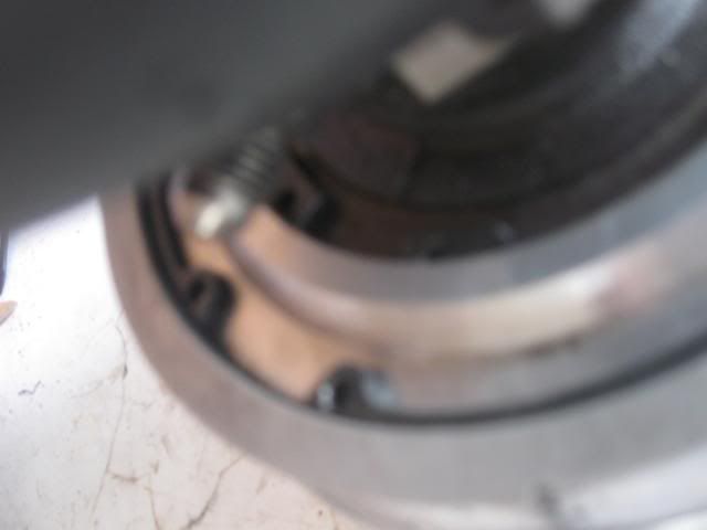

    actually having a look at the turbo again which parts are ct26 and which parts are gt35?
    cuase in that pic i see 2 circlips when there's normally only 1. if you do the inner circlip then you wont have to worry about the pin.

    Quote Originally Posted by jonathan yee View Post
    Spot on my friend, got to work today and borrowed some decent C- Clip Pliers and it rotated no problems at all. Now I have a directly vertical drain line, has cause some other issues but I'm on top of that
