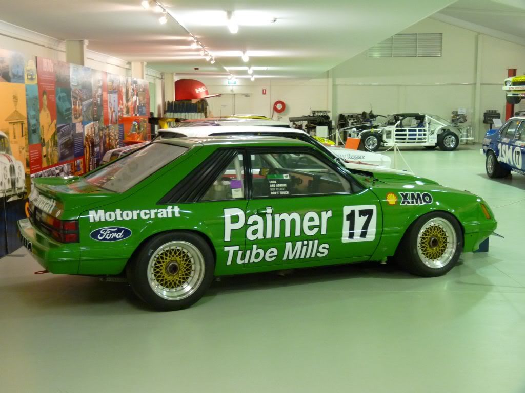

    The Fox-bodies can be a bit hit-and-miss, the Aeronoses tend to look better than the Foureyes though but each can look awesome and each can look crap. One thing to remember is that the series ran for a ridiculously long time (something like 13-14 years, encompassing the entire 80s decades) so the design did evolve a bit over that period.
    I've always liked this Fox-body

    Yeah hiro the green Johnston aeronose was a boyhood favourite! They can vary from downright ugly to quite tuff looking. A thirteen year production run also means parts are plentifull and cheap!! They more I have thought about this the more I think I could make it a serious steer not just a straight line hauler. They are a strut and rack front end so I'm sure a coilover and big brake conversion wouldnt be hard, just a little cost. And the rear is a trailing arm solid which also gives lots of options.
