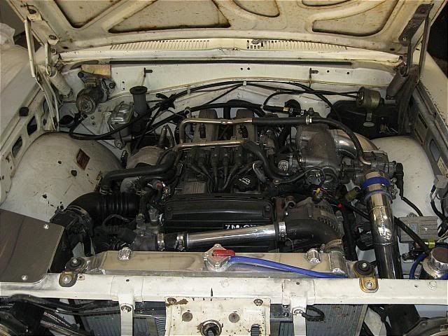

    You may need to setup like this cross flow through inter cooler
    Thats my setup and that modified manifold is for sale

    Default Re: 7mgte intercooler setup
    This is how I did my Supra
    Matt where does the pipe from turbo run down to the front left of the cooler.
    How is the lag???
    Runs just below & parellel with the radiator and then engine side of the rail to the turbo, used the original rubber hose to join between the turbo out let and the piping. From memory the tubing is 2 1/4".
    It really surprised me the lag wasn't really noticable.
    MS123 do you want any more pics of my set up, it just gets tight around the back of the lights
