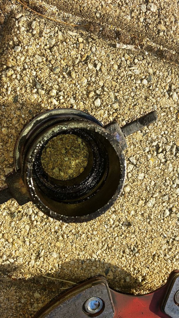

Below is the throwout bearing, are there meant to be ball bearings inside this?

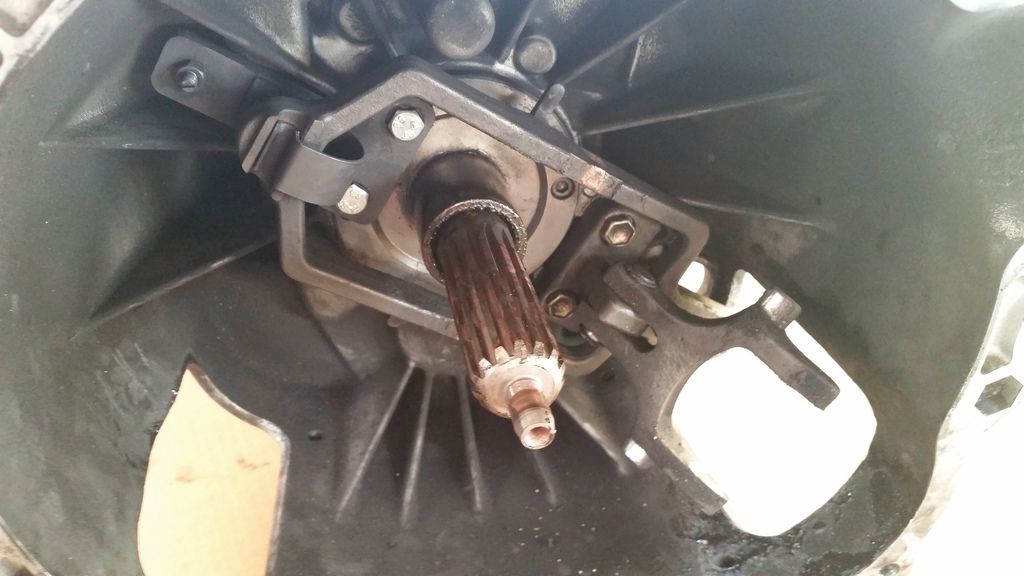

The push fork (return springs aren't shown)

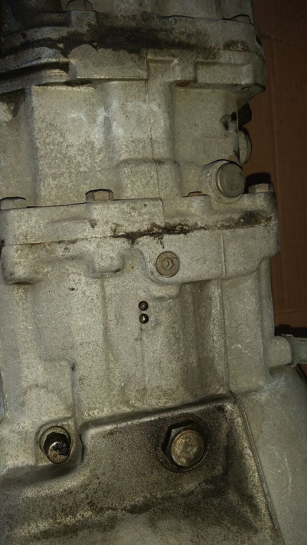

A couple of ball bearings I found on the ground, when removing the gearbox

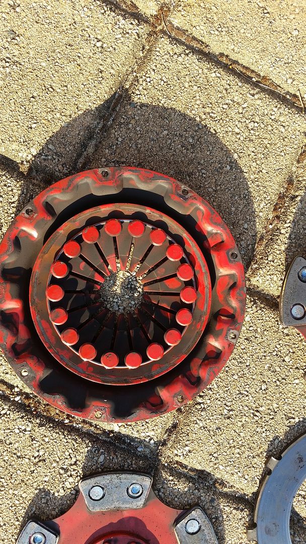

The pressure plate looks fine
As do the clutch pads

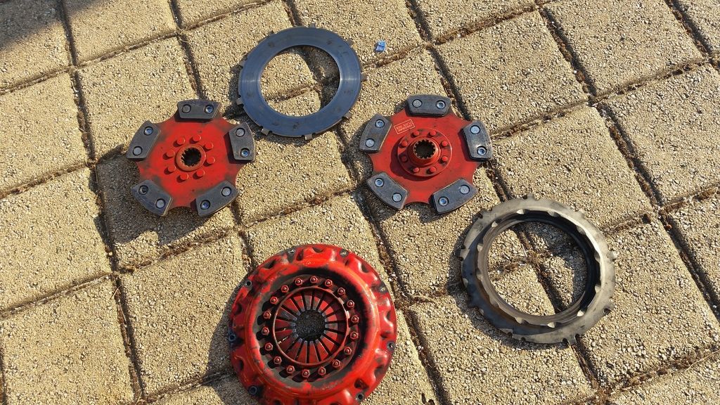

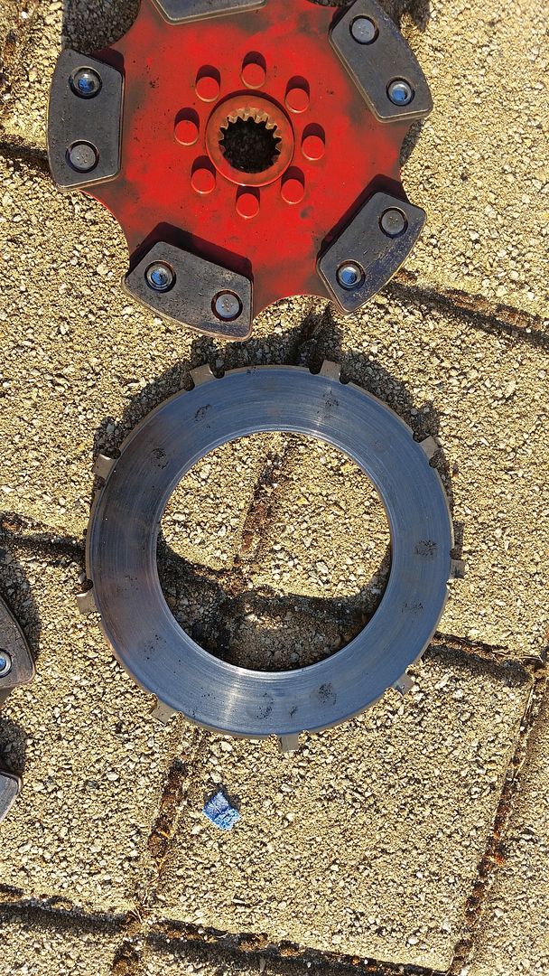

This particular plate, the one sitting closer to the engine, has developed some ridges, perhaps the plate is getting stuck, locking the clutch? I ground down 1mm off these teeth the first time I installed it, as I was having problems getting it to release (though I think that problem came down to the clutch discs being slightly warped
