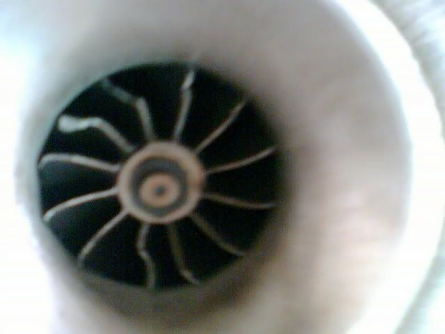

    yea ive had the boost leak issue before on my non vvti 1jz,
    the vvti ones have afm tho, but i did think of that.
    ill def have to take it apart and have a look, so if there is any impella damage or shaft play etc.
    it was just as i was driving home from work a couple days ago, nothing major really happened, it just started making noise.
    ah.. didnt know vvti ones had AFM... gay..
    depending on the damage (if any) you may be alright..
    mine was like this
    and still made 20psi, didnt grind on the housing etc.. bearings were still ok etc...
    i only took it off coz i scored a highflowed ct26 for cheap.. that td06 (above) didnt make 15psi until 5000rpm.. on a 7m
    Stomps
