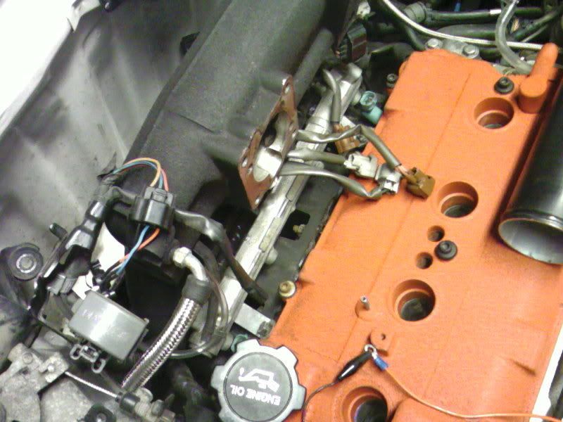

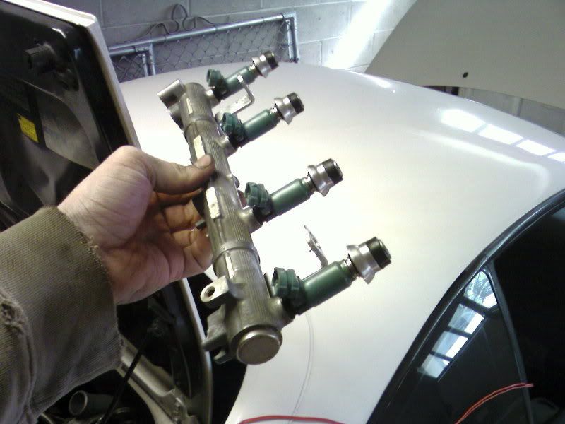

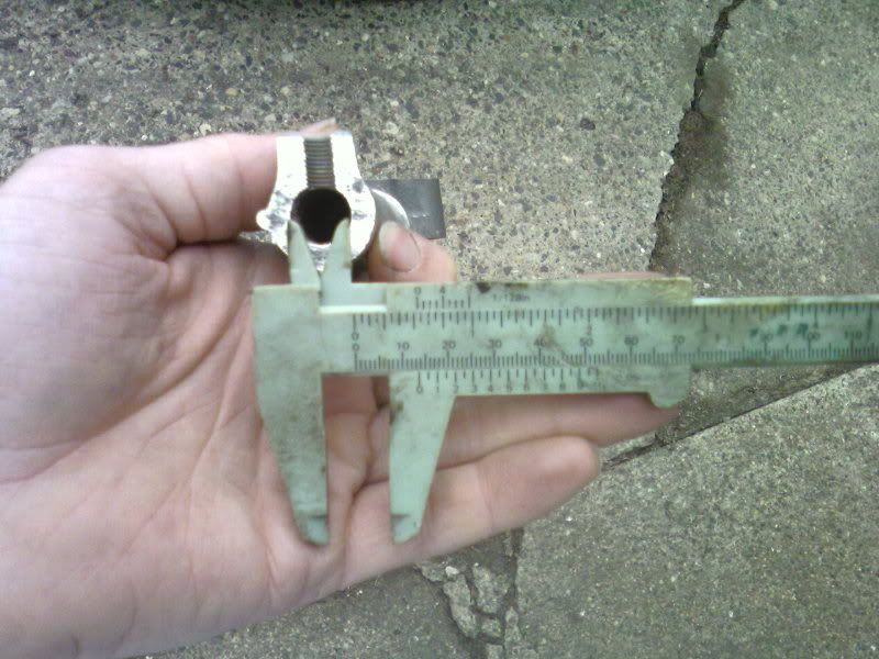

    for that matter, so can the 5SFE:
    simple brackets:
    note: these brackets were designed for WRX injectors (they flow in the ~800cc/min range when you remove the caps) which are about 1cm shorter than standard denso top feeders.
    for either rail, i used the original ends of the stock fuel rail, cut off and sealed to the injectors as seating cups:
    the 5SFE rail is bigger ID than most aftermarket rails:

    i used simple 2"x2" leg 6061 angle. the steel yard even gave it to me for free because the piece was so small (but still 3ft long). 6 cuts, 6 holes later it's on the car.
    it's a tiny amount of work for the $295 saved (the rail cost me $5 from the pick n pull).

    yup. when you measure for injector height, just subtract 2mm for o-ring crush. i ran the 5sfe rail for 2 years without an issue. the 3sge rail is even easier to get right.
