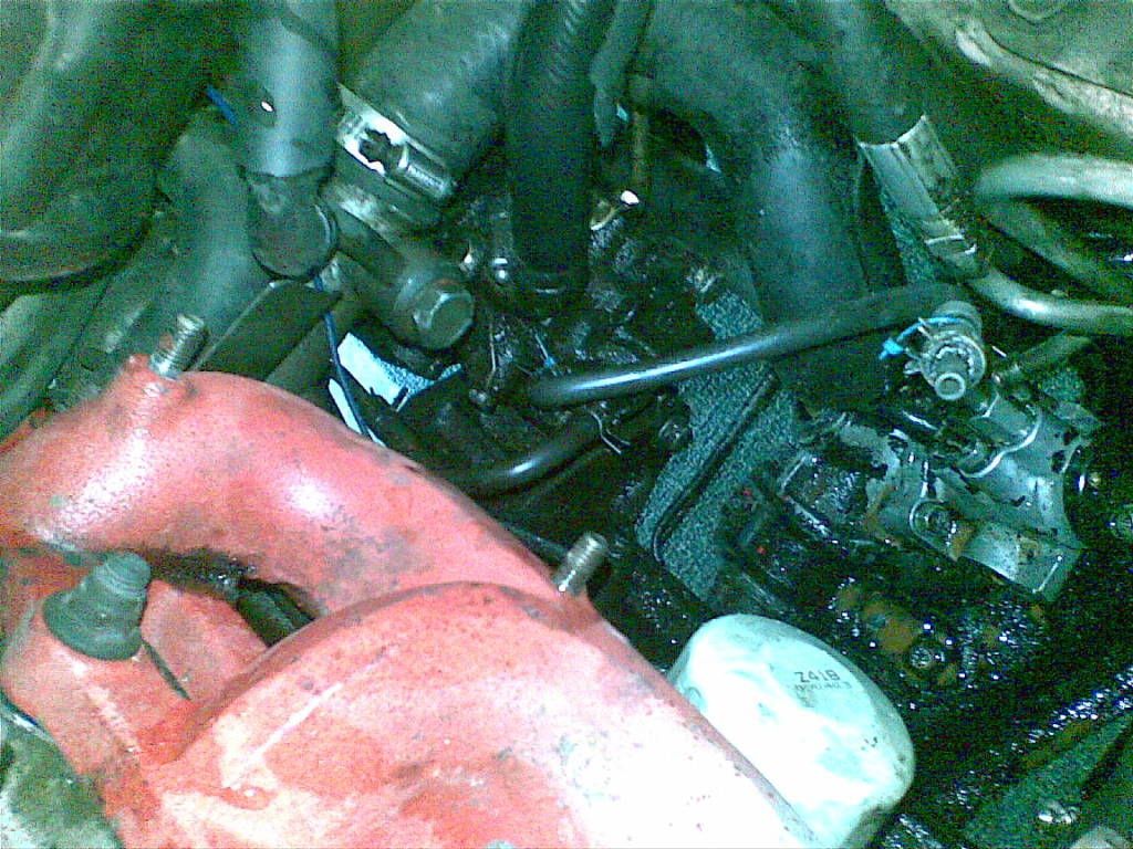

D: where does this hose go?
Not sure, try the manual http://www.cygnusx1.net/Supra/Librar...3/default.aspx

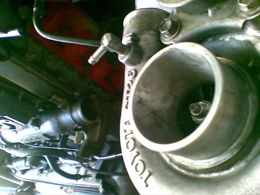

E: does this t-junction screw in here, and attach to the wastegate actuator?
Yes.

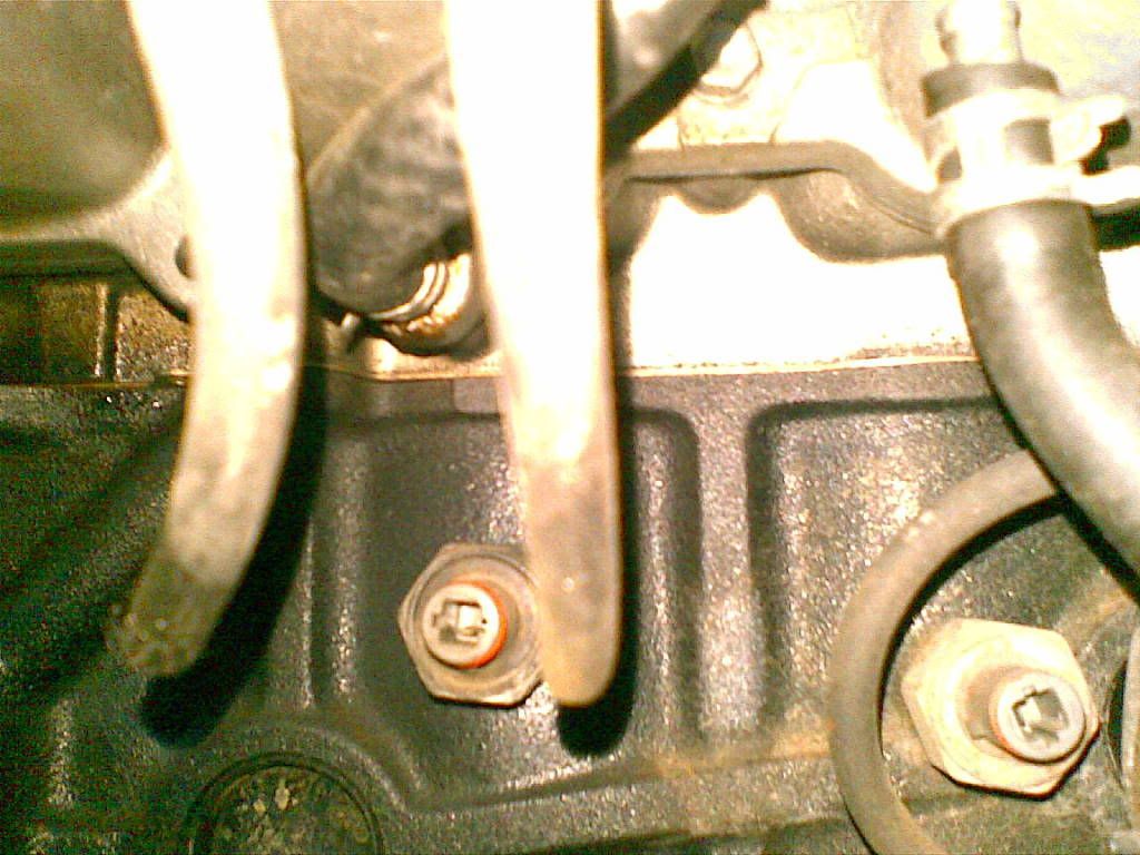

F: What sender is this, screwed into the block below the inlet manifold?
Think that would be the knock sensor.
