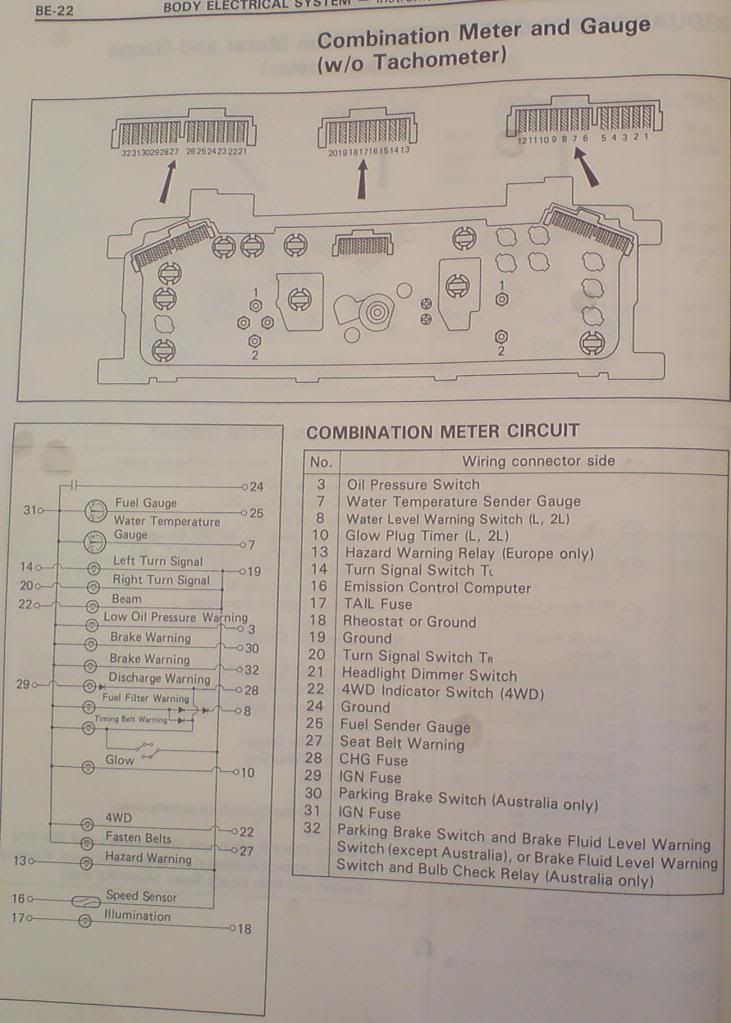

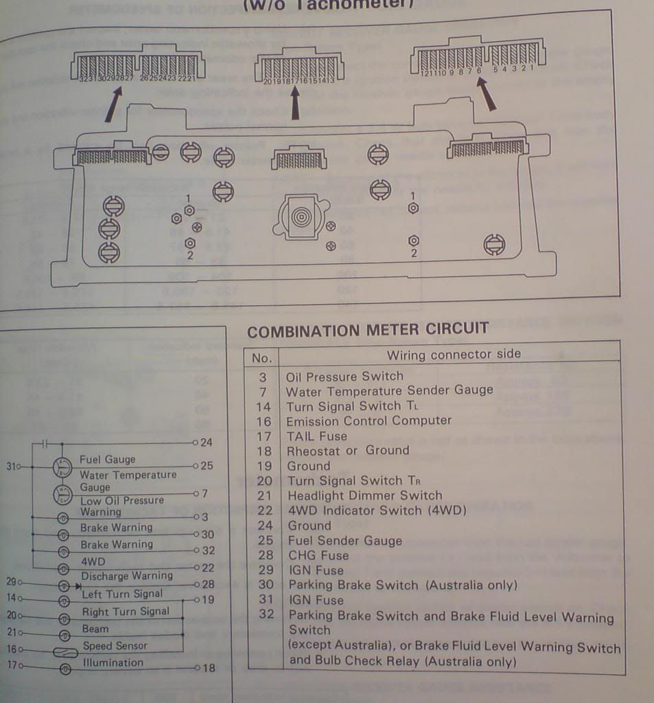

    If you did a search you would find these
    http://www.toymods.org.au/forums/showthread.php?t=54108
    Or maybe one of these is what you want

    thanks heaps man. i have been searching for weeks. must of been looking at the wrong things. thanks again
