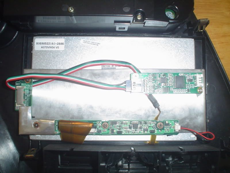

    This is what I did fro my JZA80! Probably not quite what you were thinking...
    It's a little Asus EEEPC 701SD with the screen and keyboard remote mounted
    Also has a touch screen, powered USB hub, USB-RS232s, bluetooth, and spare USBs coming up into the center console
    Laptop is mounted under the centerconsole (not shown in its mounting spot in the pic).
    Wilbo's JZA80

    Tell me how you extended that LVDS cable!!
    With a fair bit of effort to be honest!
    20 cores in that cable!
    I modified / hacked the plug ends so that I could directly solder Kynar wire to the existing connectors.
    It was quite difficult as the pin spacing is very tight...
    Wilbo's JZA80
    Wilbo's JZZ12

    Well done! I had a go at it, but wasnt successful
    I first started by cutting the original wires and stripping them back, but that was far too fragile to make reliable.
    So i then removed the plugs from the motherboard and lcd pcb, then hot glued IDC (ribbon cable) plugs to the pcbs, and linking up them up with the pcb pads with enamelled wire. 1/2 the screen worked.
    I then used a multimeter to check connections. Bad idea. It toasted the LVDS IC on the motherboard
    Ill have to use the RGB monitor out and buy a cheap 7" display off ebay.

    Yes, being able to remotely mount the screen opens up a world of possibility.
    Wilbo, you have PM.

    I love it
    Exactly what I want to do What did you do for the power supply?
