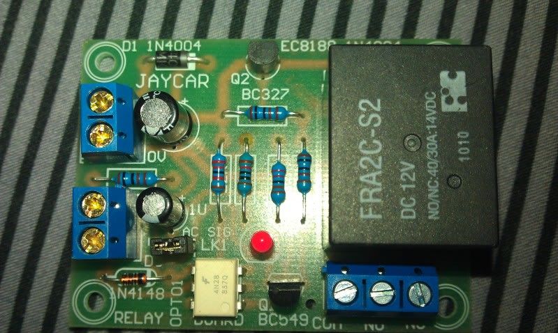

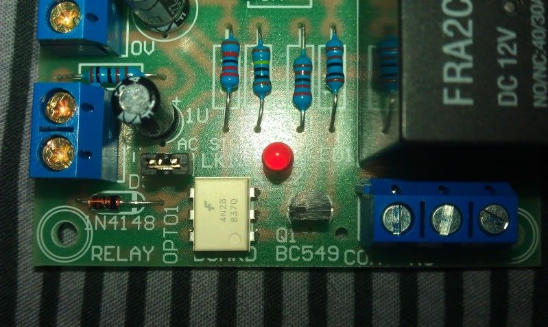

    OK so i went and bought a pack of RR0644 resistors and a 2N7000 N-Channel FET.
    now in the picture below i circled a resistor is that the one i replace with one of the RR0644 (1M 1/2Watt Resistors)?
    and regarding the bc549 i replace that with the 2N7000 N-Channel FET but when i install it i flip 180 degrees?
    I KNOW im probably annoying some people but i have next to no knowledge of any of this and im trying to make it work for me i appreciate all the help and patience!

    I also see the pictures above; if the last few are your finished board then the 2N7000 is not fitted correctly.

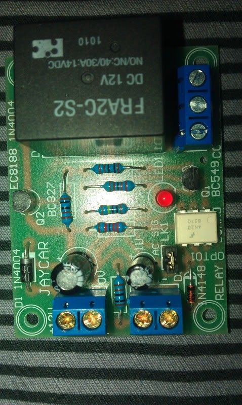

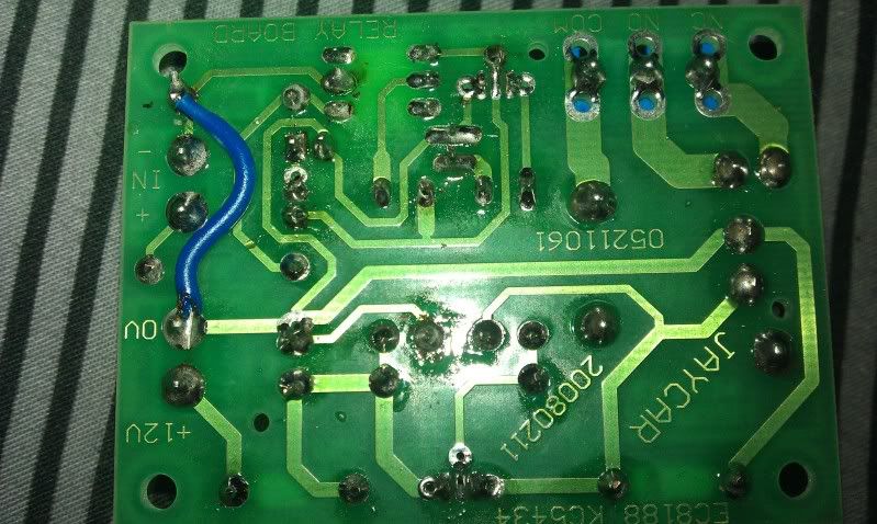

    ohk so i went over it all and soldered the 2N7000 in heres pictures of the complete thing finnished ready to be wired in tell me what you think? all good? i dont know what reverse the footprint ment i just flipped the 2N7000 180degrees
    to how the old bc549 sat

    Perfect,
    Testing
    Power up the board via IGN or battery (best to use a fuse)
    Connect the Input+ to 12Vdc. (This is OK for a short Time @ 12V I = 12mA [Imax = 60Ma] )
    if all is working the LED will light and remain lit for a short time after removing the signal.
    its now ready to wire in the car

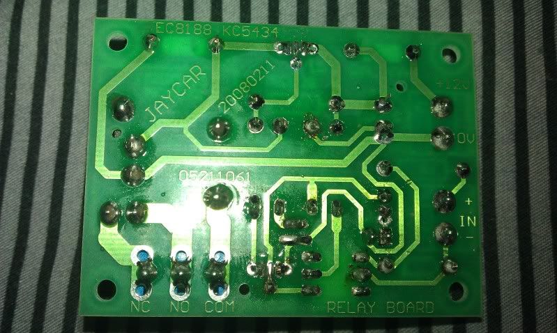

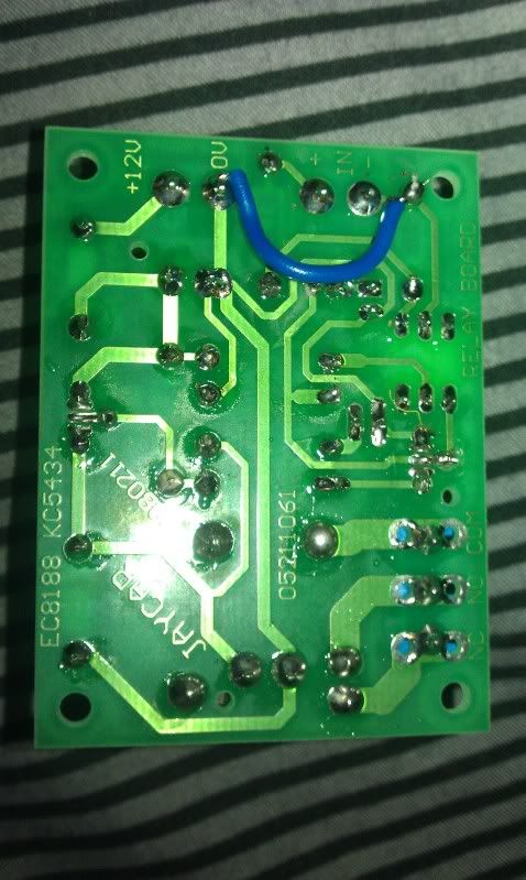

    have a look under where i soldered my link to the signal and where auto351 soldered there link to there signal ive soldered the pin to the negative input he hasnt should this matter?
