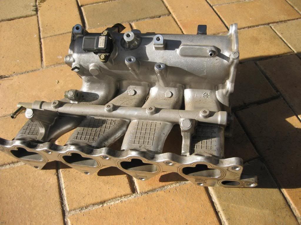

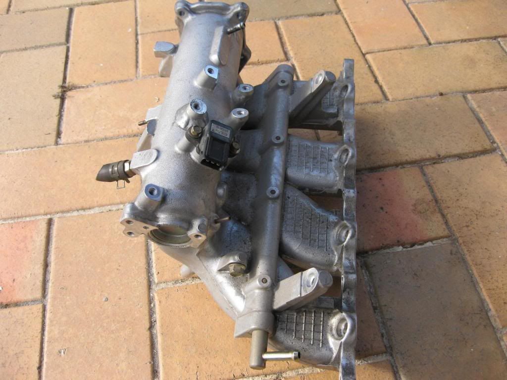

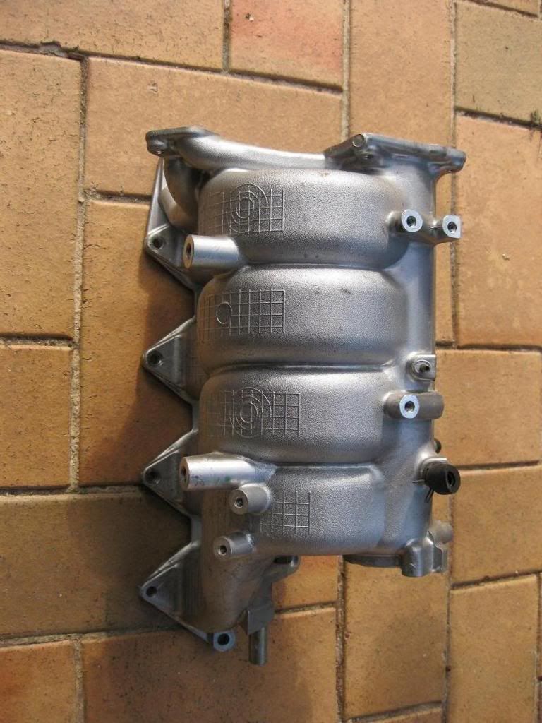

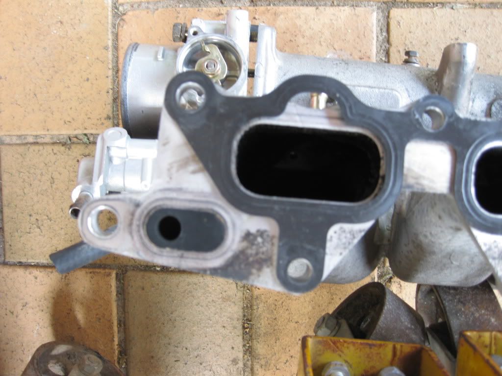

    Hi all, im doing an evo 7 motor into a KE70 and need to have a forward facing plenum as it faces to firewall in stock setup. I really dont want to atm or really cant afford to spend lots of moneys on a nice shiney new custom plenum. I had hope when i heard that the evo 3 inlet manifold had the same bolt pattern as the evo 4 - 9's so i raced out and went and bought one thinking i could get away with it but the evo 3 manifold has no injector bosses (they are in the head) and the ports are a bit off so basically would require the evo 7 flange cut and welded on to it. Too much fart arsing around me thinks.
    this is the evo 3 manifold with the evo 7 gasket on it

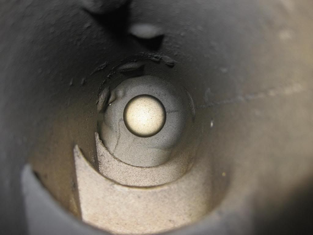

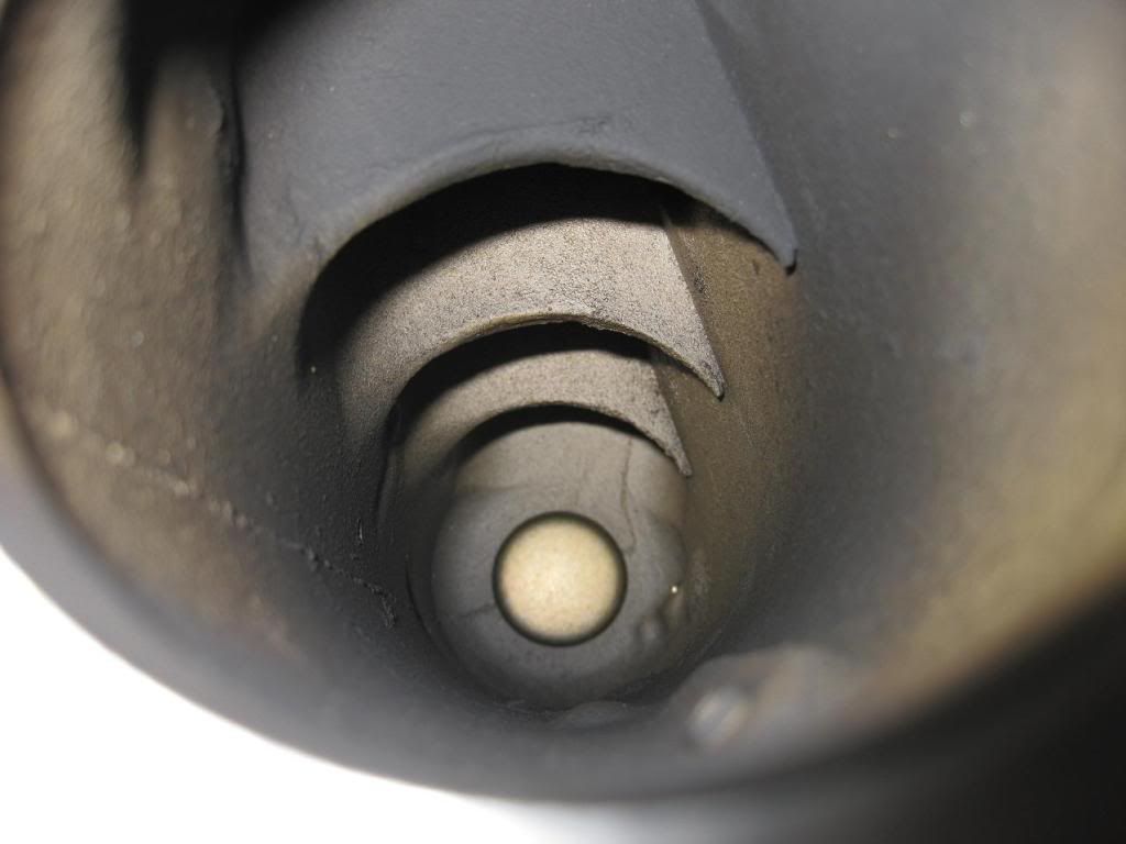

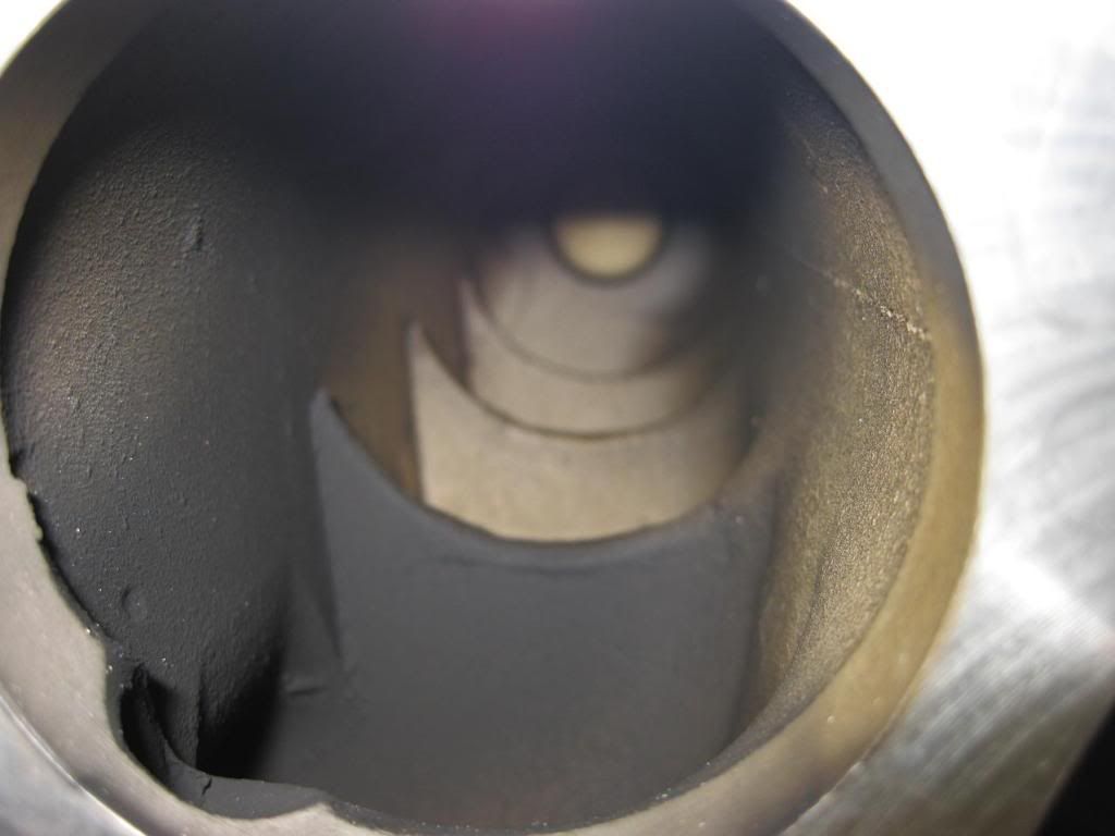

    So far ive only had one opinion and it came from someone who i believe knows what they are talking about but i need some other people's thoughts. Old mate reckon's if i cut and shut the 7 manifold i might upset the flow of the runners as the opposite side of the throttle is too close to no. 1 runner. To me i sort of agreed but then i took the throttle off and had a look inside and changed my mind a bit.
    It was really hard to take a pic of inside the plenum
    Would it help if before welding on a flange for the throttle add about 5 - 10cm of pipe the same diameter as the throttle to space the throttle away from the runners?

    why is the evo 3 manifold any better? could you cut the individual runners, flip the plenum then weld it up? this would give you a low mount manifold, but is probably worth looking in to.

    The evo 1 - 3 has the inlet and exhaust on opposite sides of the motor so the factory 3 manifold is facing towards the front of the motor on a 7. The problem i have with making the 3 manifold work is that i have to pay someone by the hour to cut and weld the runners which is a time consuming task and the amount that it would cost wouldnt be worth keeping the stock 3 manifold, id rather put the money towards a custom plenum but dont want to go over the budget i have set. So its back to the evo 7 manifold, if its just a simple cut n shut it would get me by for the mean time and put me back on track for the "budget" build.
