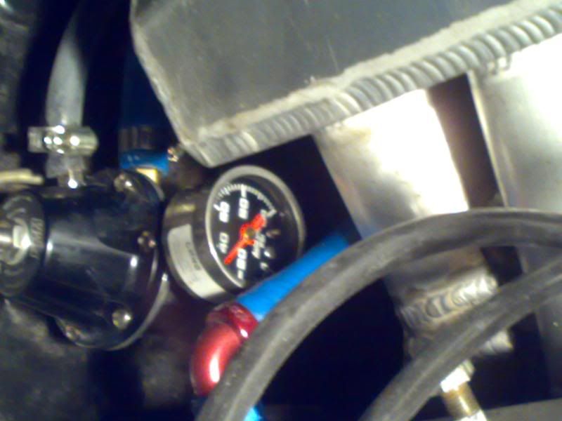

    whats everyone think of the turbosmart regs? i have one of them, will be getting tuned soon
    edit:
    it's one of these 600hp jobs, overkill for what I need but hey it was reasonably cheap and easy to adjust and even has a ricey gauge on it!
