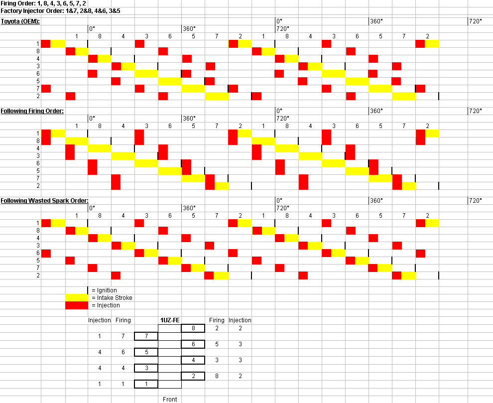

    Doesn't really look like it matters too much no matter what the order...

    Default Re: Semi-Sequential Injection - Same timing as WasteSpark Ignition?
    That Diagram is gold mate. Thanks for knocking it up, I'm gonna put that in the pool room..
    It'll be real handy.
