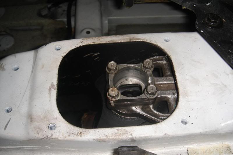

    Below is a pic of JZZ30 remote into JZA80 that I found on the internet at some stage.
    It's not my picture so I can't vouch for it, tho it does look close to what I'd expect (A few cm forward still)

    Quote Originally Posted by wilbo666 View Post
    JZZ30 remote into JZA80 works fine and is what I have in my car now. It doesnt sit quite as far back as that picture but it is indeed about 1cm further back than stock. All the stock parts bolted up fine, but the gearboot gets stretched a bit when I put it into first gear.

    Quote Originally Posted by DrNick View Post
    Sorry, I'm a bit confused with your terminology...
    Are you trying to say that is doesn't sit as far FORWARD as the picture I posted? But it is about 1cm further FORWARD than stock?
    I guess it depends on what part of the car you call the front? (Sounds like you're calling the front of the car the back?)
    Anyway I already said that I thought JZZ30 was the easiest, but I thought it was worth while to point out that I didn't believe it didn't come up exactly in the center...
    If you get a remote JZZ30, then that's easiest,
    Do you have a picture of yours you can share?
