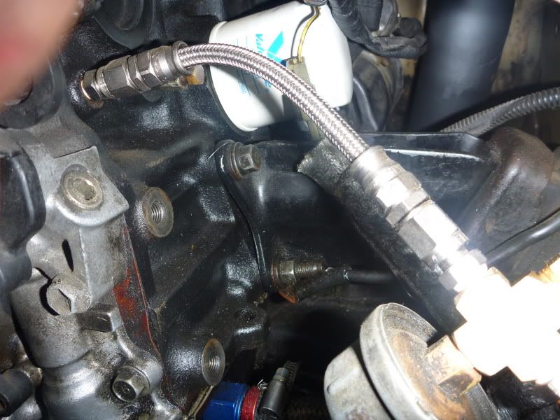

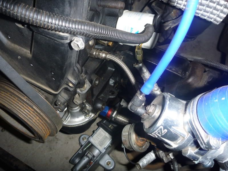

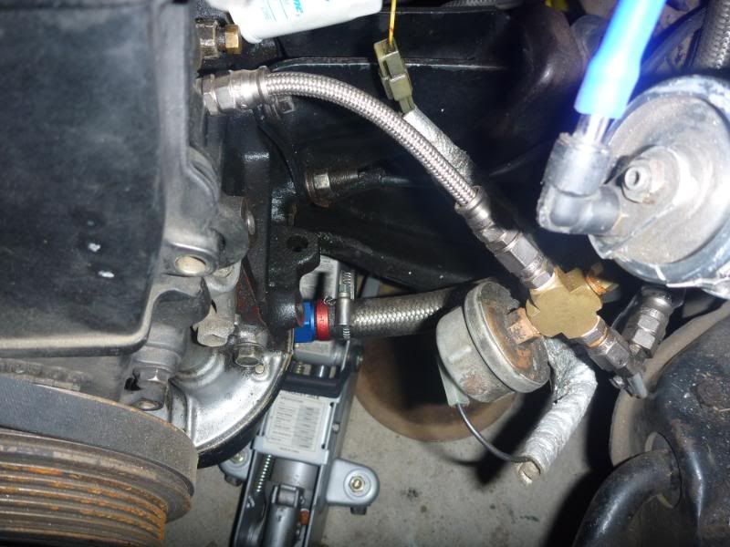

    Default Re: Turbocharging that 4AGZE Trueno Levin GTZ FWD
    Here is how I have it on mine. At first, years ago, I had a brass T piece coming straight off the block and it snapped off from engine vibration. I had to get a thread repair guy to come and remove the broken bit from my block.
    So I got this flexible line made up and problem fixed.
    The oil feed comes from the pressure sensor spot and the oil return goes into the sump, which has had a hose return pipe welded on to it.
