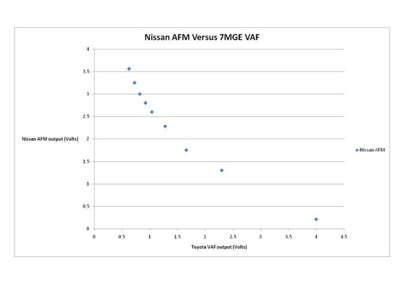

    Note Toyota VAF output decreases with increasing airflow while Nissan MAF increases with increasing airflow.

    Quote Originally Posted by amichie View Post
    Did you record air flow rates L/S by any chance?
    the toyota 1G AFM has a resistor so the output can be reversed, can the Nissan one be reversed ?
