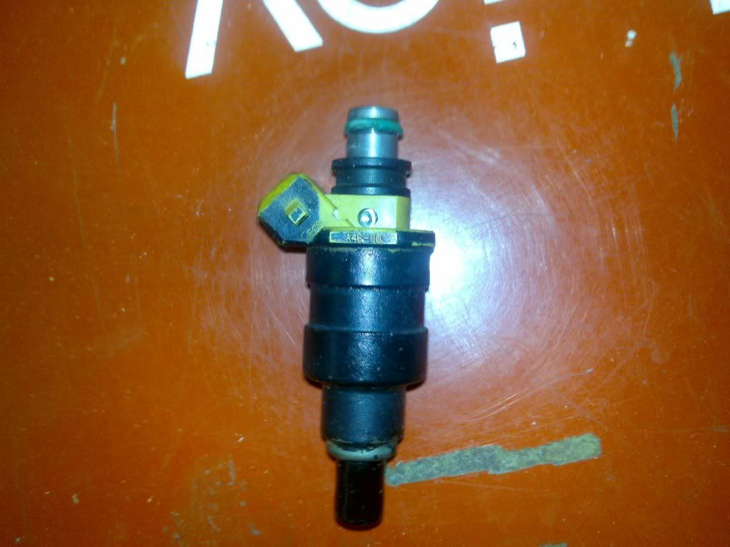

    i had 6 of these chucked in on another purchase.
    what are they from? and whats the specs if they are something different?
    the says "jecs" "a46-00" on them,
    thanks

    turns out there vl turbo injectors or something,
    245cc

    Default Re: what are these injectors for?
    They are not VLT or VL for that matter.
    A search of ebay shows a set for sale for nissan 300 & 280 ZX.
    From what i've been able to find a46-00 is meaningless. There should be 2x numbers stamped somewhere on the top. If you can find them, post them here. one of the top stamps is the part #
    ok thanks for that. it says
    0j50 9y11d
    http://www.witchhunter.com/flowdatapix/j0j50.jpg
    Top feed
    440cc/min @ 3bar
    1.6ohm
    From what i can gather 0j50 is the model number, the other stuff is batch number etc.
    440cc
    they are meant to be from gtr's. might be a nice little upgrade from the standard 1j ones.
    hardly worth it as the stock ones are only 380? if you were going to step up surely some 550 or bigger.
    This is the results i got.
    JECS (Nissan)
    Part Number cc/min lb/hr Rating @ (Bar)
    Ohm Connector
    1E00 234 22 3 12.3 EV1
    0125Z08 740 70 2.25 11.3 JECS
    2E503517 462 44 3 11.5 JECS
    8609-1111D
    270 26 2.25 14.9 Denso
    A46-00 225 21 3 14.8 EV1
    A46-F11 234 22 3 11.7 JECS
    A46-F33 450 43 3 12.3 JECS
    J54D-5F 300 29 3 9.1 JECS
    JH40-1 360 34 1 3.6
    OC55 312 30 3 11.8 JECS
    so there 225cc - 21lbr - 3 bar rating - 14.8 ohms - ev1, square plug
    Quote Originally Posted by senn View Post
    yer
    but considering i got them for free, and its a 15percent rise in flow...
    A46-00 comes up easily on a google search even though Senn says the number is meaningless. There are quite a lot of threads on that injector number.
    i don't no if anyone has relised, but the colour of the injecter make a difference on CC's
    the one's you showed are green and the 440cc are yellow. therefore there not the same injector.
    if i was wrong on my findings, i think where all wrong.
    the only reason i said they seemed to be meaningless, is that ae46-00 seemed to come up with a few different JECS injectors, with different coloured tops, most of which were listed as being yellow.
    Senn, yes you are right in that the google discussion indicates they vary from 180cc to 440cc and I guess this is where the coloured tops make the difference and the physical dimensions might remain the same.
